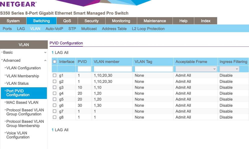

  •   I have managed to get things working. In may scenario I wanted following,
    VLAN1 (default) port 1 connects to the router. Port 2 connects to local DNS server.
    VLAN10 port 3 connects to my local admin/main computer.
    VLAN20 ports 4-5 connects to Smart TV's
    VLAN30 port 6 connects to work only PC.
    FYI, all devices use local DNS

    typical mistake is that people try it with just two VLAN - while one does need three.

      I wanted to go further with this configuration and limit VLAN1 to only ports 7-8.
      I plugged my PC to port 8 and started the config. I created new VLAN55 and assigned it to ports 1-6. Setup new PVID of 55 to ports 1-6.
      At this point I logged off, connected PC to port 3 and have internet access.
      All devices works fine.
      ISSUE:
      Going back and plugging my PC directly to port 8 I am unable to access switch GUI pages.
      Does anyone have an idea why is that?
