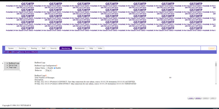

GS728TP - GUI and LLDP
Hi to all, I have two issues. Hopefully, someone can help: When I go to the web interface of the switch (doesn't matter which browser) the top area consists of the model information which repeats ...

I'm not that familiar anymore with the web-managed only switches from Netgear, but like the fully managed switches, there is a global option and a per-port option to control LLDP. Check out the software administration manual for your switch, LLDP is mentioned starting page 56.
According to the screenshots, I suggest first checking if LLDP is enable at the switch level at all, then check the "Admin Status" at the port level, you'll have to set it at least to "Rx only" in order to receive any information from LLDP-enabled devices connected to a switch port. If you want to send out LLDP frames from the switch, set it to "Tx & Rx". (And there are other additional options what data is being sent out ...)
