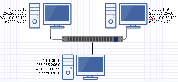

The setup is like this:
The 2 PC's on VLAN 20 can ping each other, they can even ping the interface of VLAN 30 (10.0.30.199) but they can't ping the PC on VLAN 30 (10.0.30.10).
The PC on VLAN 30 can ping the interface of VLAN 20 (10.0.20.199) but it can't ping any of the PC's.
The PC's are all connected on untagged ports assigned to that particular VLAN and the VLAN is assigned through PVID configuration.

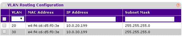

VLAN Routing looks like this:

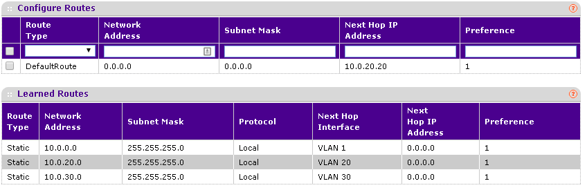

The routing table looks like this:
