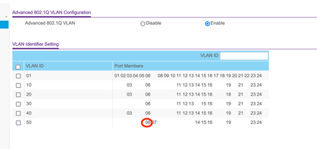

As the title says, I have a JGS524PE that loses it's VLAN configuration for a specific VLAN on a specific port on a reboot. I am running firmware 2.6.0.48. All other VLAN configs work perfectly fine....

Just curious: In 802.1q, VLAN Membership, Advanced - if adding yet another random VLAN with some ports marked as Tagged, does the issue remain on the previous config?

I just added VLAN 123 with various ports added as tagged ports. I rebooted and all settings remained EXCEPT for VLAN 50 on port 6.
Before reboot:
After reboot:
- bubbagump210Dec 06, 2022AspirantAs a next step, I deleted VLAN 50 and recreated it as before. The same behavior returned on port 6.
- schumakuDec 06, 2022Guru - Experienced User
Have no such device for a check, but suspect a bug in the firmware because I'm reading about such issues for the n-th time. DaneA please.
- bubbagump210Dec 06, 2022AspirantPerhaps not coincidentally, when I went to delete VLAN 50, it complained about port 7 having the wrong PVID. Port 6 is what had the PVID not set to VLAN1 in reality. Perhaps a GUI issue, but I suspect a deeper issue where there is an off by one issue causing the config to clobber the wrong port.
