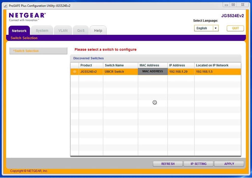

Thinking it may be out of date SW, I’ve removed V2.2.34 of the Utility and installed the latest V2.7.2. No luck! Getting exactly the same problem. The Utility detects the Switch (the only one on my network), allows me to select it and enter Apply, which brings up a Login Window that first asks for Username and Password, then quickly changes to just Password. On trying what I thought was the password I had set in 2015 (the same as my online account) I get “incorrect password”, so clearly I didn’t change it as I’d thought! However, using the default ‘password’ does look like it’s going to work because the Utility screen now shows my model number in the top right corner, and also in the name of the software in the top left, but I just get an endless clock cursor going round and round – and that’s it! I can never get any further.

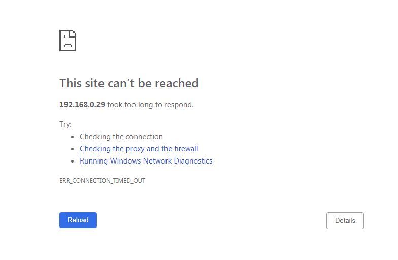

I have tried the web interface using the IP Address showing on the Netgear Utility, and the Located on IP Network address – but neither allow me access. I have tried all of the above with my ESET Internet Security Suite V.12.0.31.0 turned off – so no firewall or other protection to interfere – still no luck. I’m afraid I don’t know what my Switch firmware is and I have no idea how to check or update it without access via the Utility.

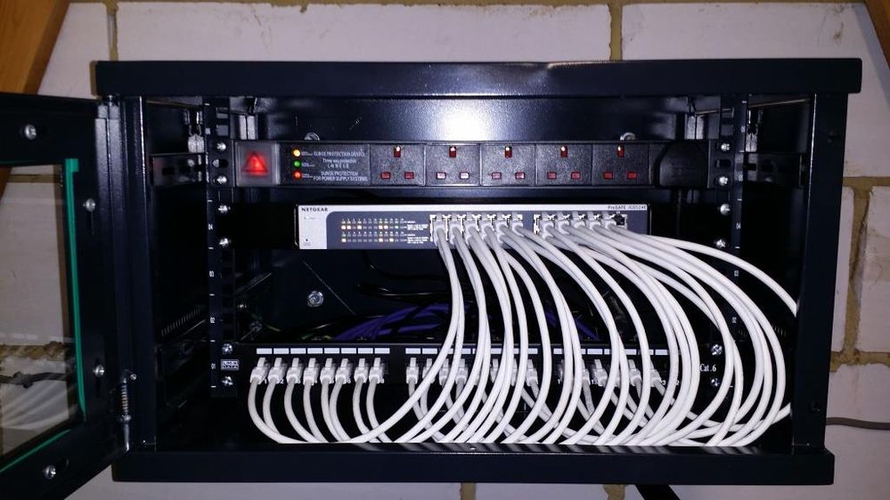

I have added photos of my Switch setup, and the Utility and Web interfaces in the hope that someone can offer advice on how to solve this problem as I have spent hours and hours trying to find answers to this with no luck. Thank you so much.
Switch Setup

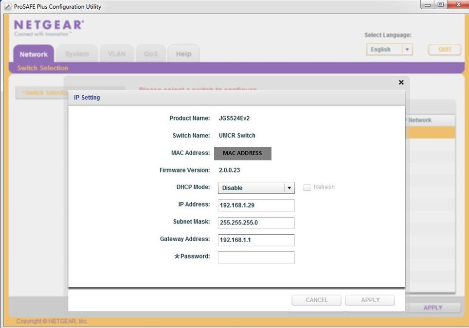

  • After my first post I wondered if Safe Mode would make any difference so I tried logging in that way, and after allowing windows firewall access (which popped up as ESET was offline) I was still not able to log into the Switch. I did however, disover that I could click on IP Setting and find out what Firmware I was using so I can now confirm that it is 2.0.0.23. Does this help at all?!!

      Uploading removed images with the MAC Addresses covered:
      Utility Log In Screen with Timer Cursor
      Firmware Version under IP Setting
