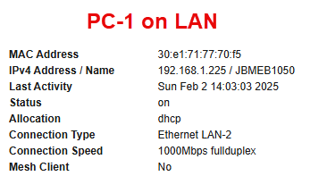

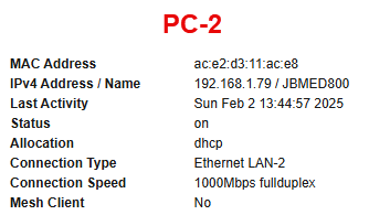

        Here is what I'm seeing in the Router/Gateway.
        This is the PC that always has a 192 address
        Here is the PC that sporadically gets assigned a 169 address. However, wouldn't you know when I just rebooted, it was assigned a 192. address.
        Here is the same PC-1 when I switch to wifi and always gets assigned a 192. address
