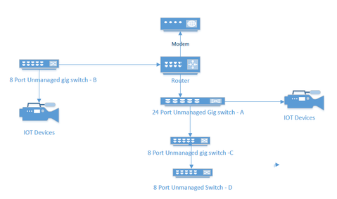

Network switch selection for VLAN design
I currently have an unmanaged network consisting of a 24 port switch, 3 - 8 port switches, a Netgear RS series router and a cable company supplied modem.  Several IOT devices reside on this network, and I would like to redesign to include managed switches to facilitate the use of VLANS to segment  my IOT and streaming devices.   A rough picture of the current design is below.
My Questions.
  1. Should I consider replacing Switches A and B with new managed switches or can I get away with replacing the 8 port Port switch at B and put a new 4 port switch between the IOT devices and my main 24 port switch.  ( and no, because of location and wiring constraints switch B must also connect to router.
  2. For the purpose of establishing simple VLANs for IOT, would the GS 3xxseries (GS 308E and GS305E) easy smart managed switches from Netgear work?
    FWIW, you haven't said how the streaming devices are connected.  Are they also connected only to switch A and B?
    Another aspect is how much isolation you want for the IoT devices.  You won't be able to isolate them from the wifi network with this arrangement, since the RS routers don't have the VLAN features you need.  I am assuming you want that isolation.
    You could connect a wired router (or L2/L3 switch with routing functions) to the modem, and then use the RS router as an AP.  As far as Netgear kit goes, the GS728 series switches have routing functions built in, so you could potentially connect one of those to the modem.  Ideally this would replace switch A, though that depends on whether wiring allows that. Check the manual to make sure it has the routing functions you want.
    Of course, one of Netgear's fully managed switches would also work as an edge router.
    Is the modem actually a gateway (perhaps in bridge mode)?  If it is, you could use the gateway as the edge router (turning off the wifi), and continue to use the RS router in router mode.  Then use switches connected to the gateway for the wired IoT devices.   These could be unmanaged switches, since the NAT in the RS router would prevent the IoT devices from reaching the RS router network.  The RS-connected devices could still reach the IoT devices.  The downside here is that you'd have a double-NAT configuration.  This is managable, though a bit more complicated if you do port forwarding.
    The third option is to get a new small wired router with full VLAN support, and use the RS router as an AP.  Unfortunately, Netgear doesn't sell one, so you'd need to use another vendor.  As far as switches go, if you have only IoT devices connected to switch B, you'd be able to use connect it to the wired router, and set up the router LAN port as an untagged VLAN.  You could also get a small smart switch to connect the IoT devices currently on switch A to the wired router (also connecting that to existing switch A).  The GS305E or GS308E switch would work for that.

      If your main goal is just to isolate your IoT devices from the rest of your network, you probably don't need to replace every switch right away.
      I'd prioritize replacing the switches that actually need to carry multiple VLANs (trunk links). Any switch that's only serving devices from a single VLAN can stay unmanaged, as long as everything connected to it belongs to that same network segment. The important part is that the links between your router and the managed switches can carry the VLAN tags correctly.
      The GS3xx Easy Smart switches should be fine for a straightforward home setup with a few VLANs. They're not as feature-rich as fully managed models, but for creating separate IoT, LAN, and maybe a guest/streaming VLAN, they generally do the job without being overly complicated to configure.
      One thing I'd also think about is whether your Netgear RS router supports the VLAN setup you want (inter-VLAN routing, DHCP per VLAN, firewall rules, etc.). In my experience, the router's VLAN capabilities tend to be the limiting factor more often than the switches themselves.
      Do you know which exact RS model you have? That would make it easier to say whether your current plan will work as expected.

  • Actually I think I may have figured out part of my questions.   It seems that any switch which wither has to support multiple VLANS or forward VLAN traffic need to be managed.  So in my config Switches A B and C would need to me be managed.   It also looks like I will need to change the configuration so Switch A chains off Switch B, and that hooks up to the router instead of both A and B.
    Stephen, I am curious about your comments on wireless traffic.  Right now no IOT device communicates on Wireless.   Any wireless TV or phone only uses my guest network.  I only use main wireless for a couple of laptops.   Are you saying that if I implement vlans appropriately at the switch level, the router will still see these as part of the whole network including the non-guest wireless, thus violating the isolation between them?
      Not quite.  If all devices connected to a switch are on the same VLAN, then that switch does not need to support VLANs (and can be unmanaged).
      In your current configuration, the router needs to support VLANs, as well as switch B.  Switch A might not.
      If you put a smaller smart switch between the router and switch B that supports VLANs, then you can move all the IoT devices to that new switch.  In that case, you can continue to use switch B as your main switch, as it wouldn't need to support VLANs.
      The way this works is that the port on the new switch that is connected to switch B is configured in the new switch as being on the main network.  VLAN tags aren't needed for that port.  The port connecting the new switch to the router is set up as a trunk - carrying traffic from all devices to the router.  So that port is configured to be in all VLANs (including the main network), and the packets would carry VLAN tags.  The associated router ethernet port also needs to be VLAN aware, and be able to handle the VLAN tags.
      Similarly, the router port going to switch A is either dedicated to the IoT VLAN (if only IoT devices are connected to it), or it is also a trunk connection like the one to the new switch (if there is a mix of IoT and main network devices).
      But there is another piece of the puzzle.  Even if you have an IoT VLAN, your main ethernet-connected devices won't be isolated from the VLAN unless you set up the routing to preserve the isolation at layer 3 (not just layer 2).  The RS series router simply doesn't have the features you need to do that.
      Double-routing (as I suggested in my first response) is one work-around, or you can get a wired enterprise-class router/firewall, and use the RS series as an AP.  There is significant learning curve if you go with the enterprise-class router.

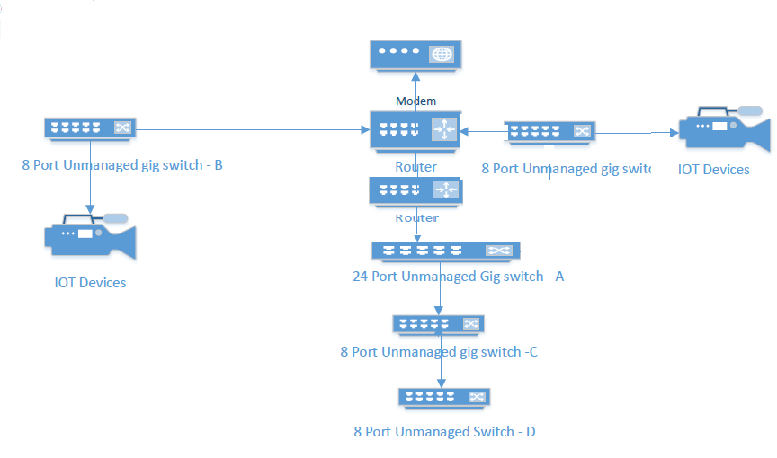

        Here's what double-routing would look like.   You'd add a consumer router and an unmanaged switch.  The graphic is messy (I started with your diagram), but this should give you the idea.
        Only the IoT clients are connected to the top (edge) router.  All your other clients are connected to the bottom (inner) router.
        The IoT devices cannot reach your other clients, because the NAT in the inner router blocks that.  But the regular clients can reach the IoT devices.  (Media streamers might need to be connected to the inner network).  The two routers would use different IP subnets - for instance, 192.168.1.x for the edge router, and 10.0.0.x for the inner router.
        It should be less expensive than your VLAN implementation, as that requires replacing the router with an enterprise class one and maybe adding smart or managed switches.  Also, easier to set up, since there is no learning curve.
