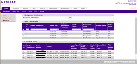

Hello,
We have a stack with 4 switches (GS752TXS model). One of them (unit 2) failed and we replaced it with a new one. The new switch (unit 2) is well detected by the master and works great (see b...

Thanks for your reply. Something is strange because the other switches included in the stack (no1, no3 (master), no4) can be accessed directly with their specific IP static address. So, why do we have a behavior difference between unit 1,3,4 (that can be accessed) and not the unit 2?
Thanks for your help.
Franc
