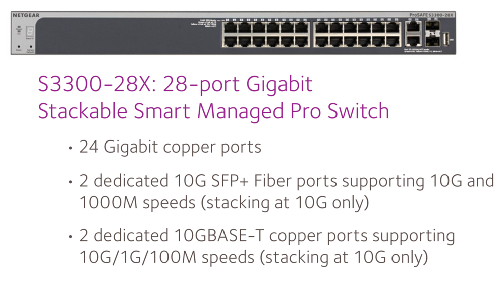

Reason for my curiosity question was hat I was not aware of such a Netgear switch model with GbE plus four SFP+. On the GS728TX (and all four S3300 models), of the four dedicated 10 GbE ports are two 10GBASE-T, and two are SFP+:
Said that, all the 10 GbE ports are generic ports, available for any purpose at any speed (except of the new 2.5G and 5G MultiGig).
What I don't know is if Netgear does enforce the usage of Netgear SFP+ modules with a Netgear ID on this model line.

In general yes, there is non-blocking almost full wire switching speed on all 10G and 1G ports, any to any.

For example the S3300
http://www.netgear.it/business/products/switches/smart/S3300-28X.aspx#tab-specifichetecniche
It has 24 normal port at 1Gb and 4 sfp+ 10Gb ports for uplink/stacking.
They only speak of "uplink/stacking", so instead you say you could set VLAN and other rules also on these 4 sfp+ ports? And communicate with all the other ports like if they were normal access port, even L2+ routing and so on?
