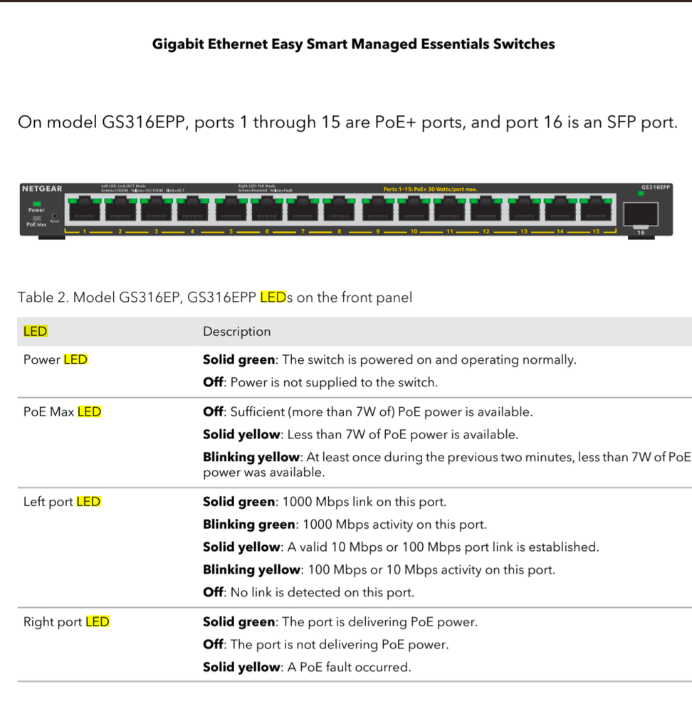

Switches indicate receiving signal, not detecting devices
I have had a GS316EP for 4 years. It was used to power 2 PoE cameras and for my home office. About a month ago, it stopped working. When I plug the Cat 5e from the router into each port, they light up and I can check the status when I access the switch via the IP address. It shows 1 connection, despite there being at least 3 others attempting to pull/send data.
I purchased a GS3116PP Unmanaged Switch to replace it, thinking it was a dead switch, and it is doing the same thing. I have changed the cord from the router, trying a different cat 5e and a cat 6. No improvement.
Firmware has been updated on the managed device. The unmanaged device was left plugged in for over an hour, despite instructions claiming it should only take 2 minutes.
Any help would be appreciated.
    So what signals are you talking about please?

      Power supply is the factory power supply that came with the switch. The indicators that I can see are the Power LED and the Left Port LED for the port coming from the router. There are no other LEDs lighting up and none of my other devices are receiving internet or power from the switch.
      There are two PoE camera which are not receiving power or internet and my PC, which is not getting internet signal either.

      The only device indicating that is connected and active is the router. No other devices have any indication of activity.
