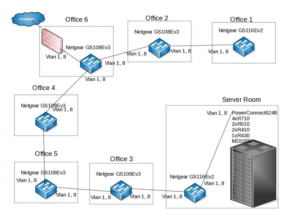

Hello. I have the attached network with netgear vlan config (above) on all the netgear switches.
Vlan 1 - 192.168.1
Vlan 8 - 192.168.9
I can ping 192.168.9.1 (FW vlan interface) from any Netgear switch. My problem is I cannot ping 192.168.9 (vlan 8) from powerconnect 6248 switch or from any server hanging off of 6248. I can get to any 192.168.1 computer from any server that's connected to the 6248. Here is the interface config for port that is connected to server room netgear switch:

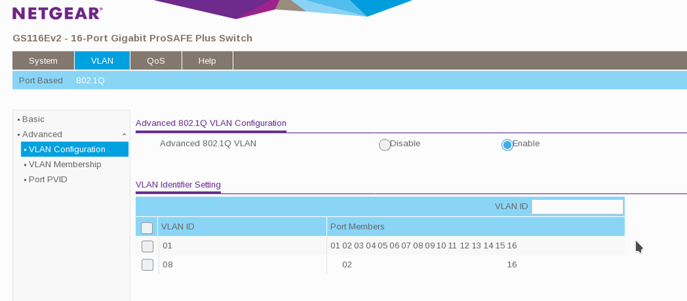

All the netgears VLAN are configured the same as the GS116Ev2
Show the VLAN Memberships page for VLAN 1 and 8 on the Netgear switches.
