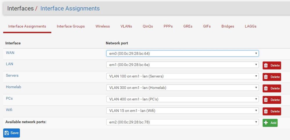

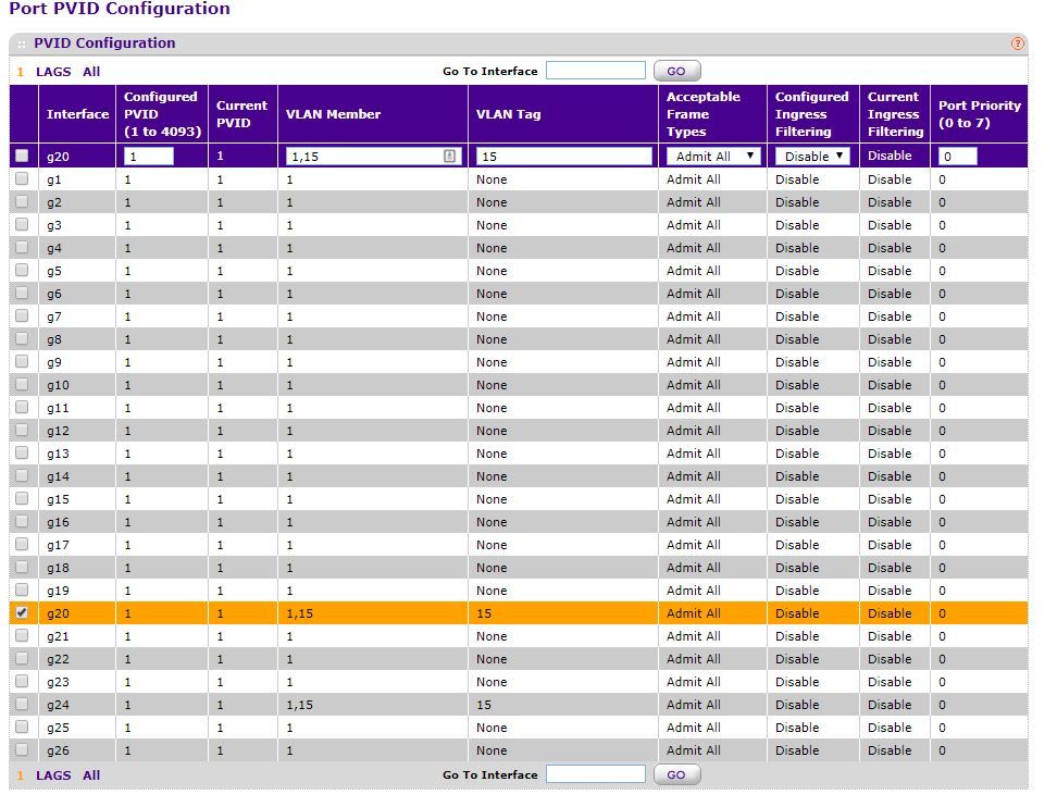

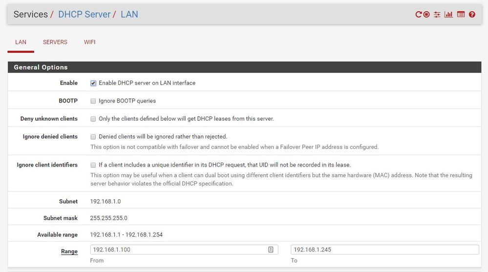

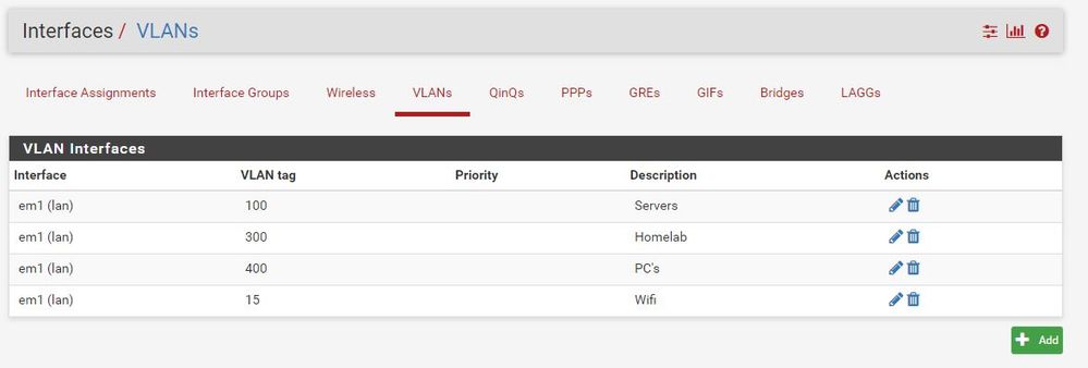

My goal is to separate my wifi from lan. I created a vlan 15 for my wifi and asigned that vlan to my lan network port (em1). Enabled with static ipv4. the Ip adress is 192.168.3.1/255.255.255.0

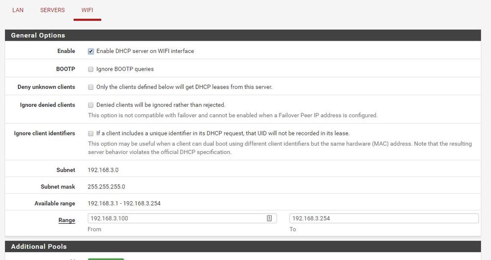

Wifi dhcp enabled and range from 192.168.3.100 to 192.168.3.254

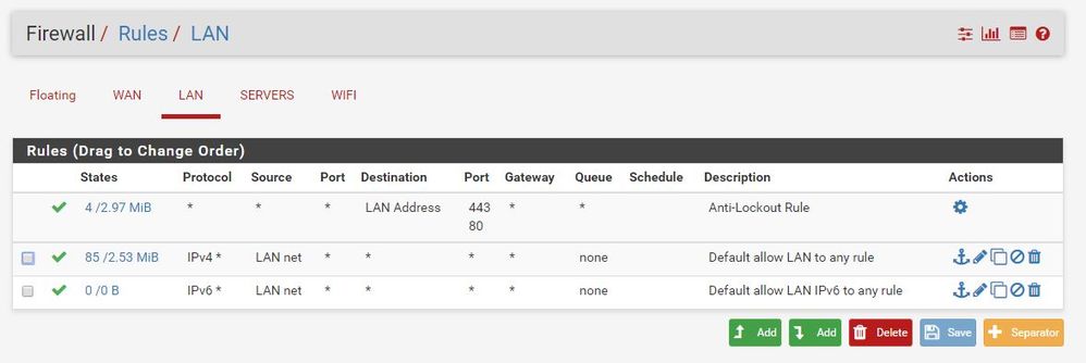

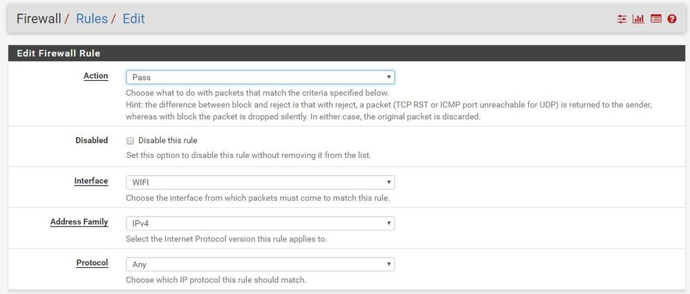

Made wifi firewall rule and passing any protocol.

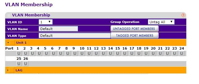

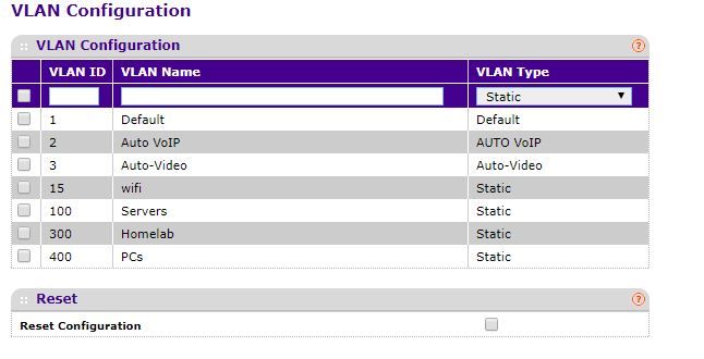

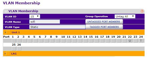

On my switch I created vlan 15, port 24 tagged and port 20 untagged.
My problem is that if i connect a test pc to port 20 it still gets ip adress from the lan scope and not from the wifi scope.

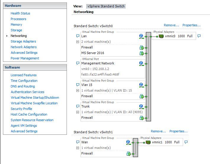

On the esxi vswitch  I created vlan 15

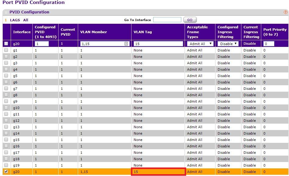

    As per checking in here that your computer is still receiving an IP from VLAN 1. As I checked your configuration, the PVID is still set to VLAN 1 on port 20. Basically, If it is a T or TAGGED port, this means that this port was set to trunk. If it is UNTAGGED or U, then it will be an access port and you should also set the PVID to specific VLAN to where you wanted it to pass through.
    You were also saying that you connected your computer to port 20. But the assignment that you had on the image was set to port 22.
    You should've set port 20 - U, PVID 15 under Port PVID Configuration. You may also remove the VLAN TAG 15 on port 20 as it is already on PVID 15.
