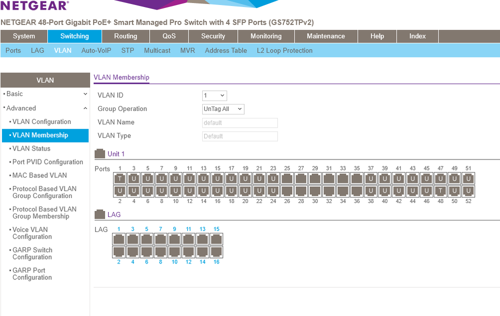

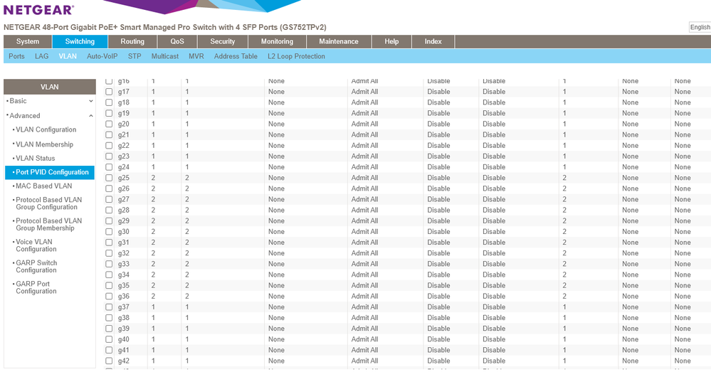

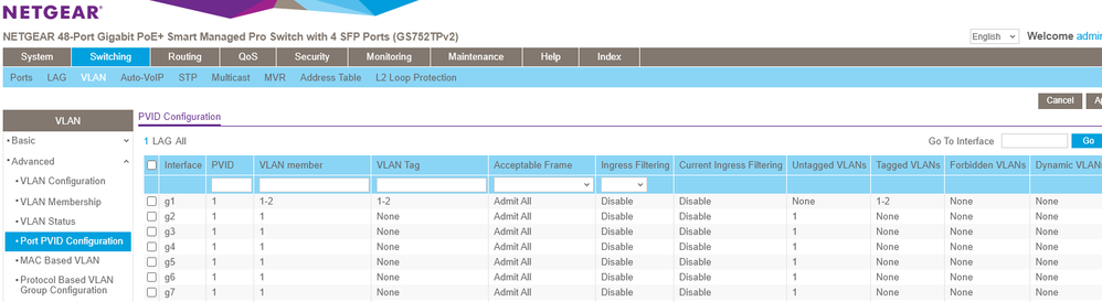

  • Assuming the native VLAN (something that does not exist on Netgear switches) is the VLAN 1, and more specifically the Access Ports 2...24 and 36...52 (excluding the Tagged port 48): Have an eye on "Configure the PVID settings"  on p.171 ff. on 24-Port and 48-Port Gigabit Ethernet PoE+ Smart Switches with 4 SFP Ports User Manual
    The PVID does define the VLAN untagged frames flowing into the switch port are associated to.

      Hi @JNBTECH,
      Change back the PVID of ports 25-26 to 1 and should be able to receive VLAN 1 in those ports while the said ports will also receive VLAN traffic from your VOIP /or voice VLAN. Give this a try a let us know.

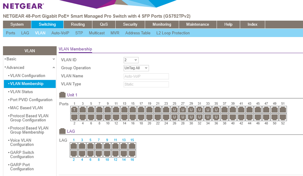

        Change back the PVID of ports 25-26 to 1 and should be good.
        Good for what exactly please? For some reasons the OP has certainly defined the port 25-36 as access ports for the VLAN 2 - and simply missed to set the PVID accordingly.
