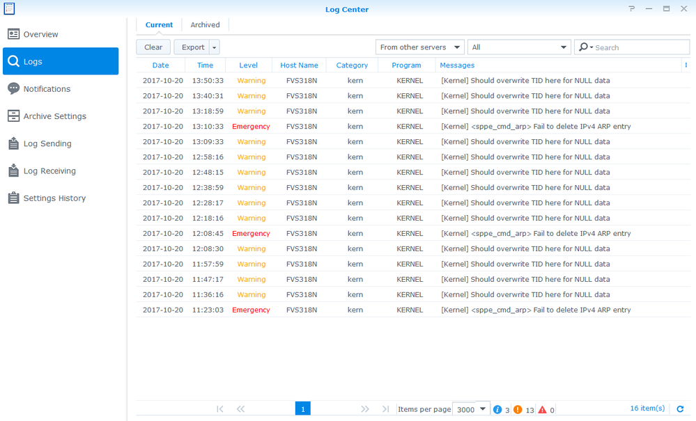

Here are some of the messages that appear on my syslog server:
[Kernel] Should overwrite TID here for NULL data
[Kernel] xt_TCPMSS: bad length (589 bytes)
[Kernel] <sppe_cmd_arp> Fail to delete IPv4 ARP entry

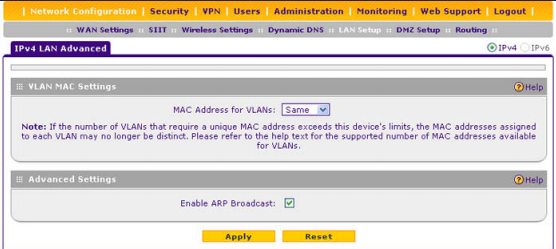

It seems that you were having issues with arp table. Have you tried to enable/disable the arp broadcast? Go to Network Configuration > LAN Setup - Advanced(Upper right corner) - Enable ARP Broadcast then hit Apply.

it's on by default. Disabling it seems not like a solution to me. Seems like a workaround.
and what about the other two messages:
especially the first one does appear a lot in the log.
