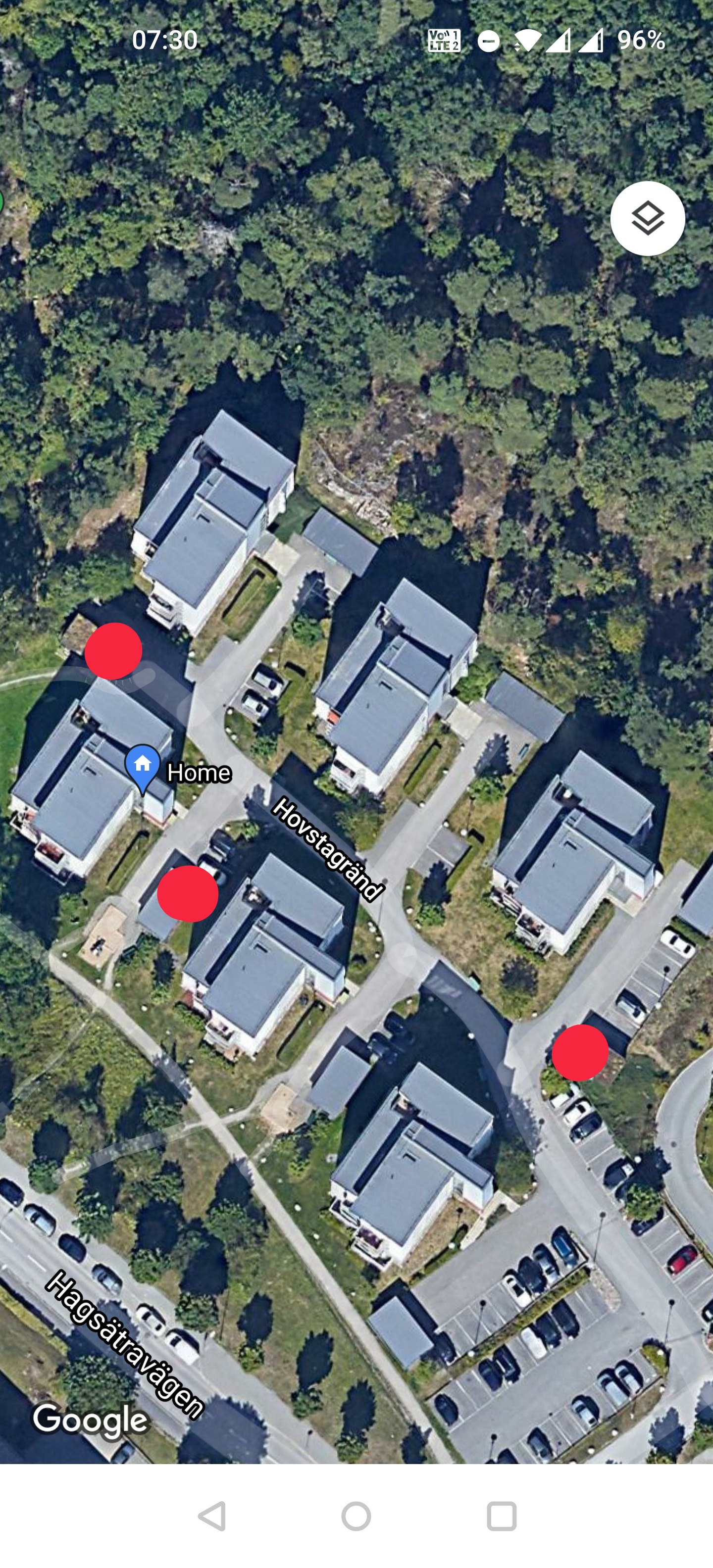

question 3. is line of sight required for connection? is it possible to airbridge through thin walls? I.e see attached picture. The idea is to create a multipoint link to two satellite sites. They're within 30 and 70 meters each. The closer site does not have line of sight, it's missing about 3 meters, so the corner of a building is in the way, the building is not concrete or dense.
    Yes, line of sight is required.

      in your answer for question 3 you state the answer line of sight is required, however in the answer for question 4 it clearly says "should have a direct line of sight" not that it's required. This is misguiding, should it have direct line of sight or is it required? if it only should have then it would be possible it works in the scenario i have.
      anyway i guess ill have to try. if the "no line of sight" and/or multipoint doesn't work i have the idea to try a mikrotik wireless wire for my secondary connection as it wouldn't require it's own poe injector.
