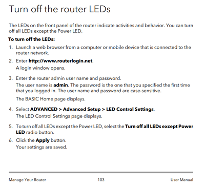

    Very unclear what AX1800 you are talking of here. Find the exact model (printed on the label) and locate the user manual on https://www.netgear.com/support/
    The RAX10 and RAX20 (and probably others) show a control to "Turn off the router LEDs", here from the RAX20 User Manual, p.103. Not on a schedule however.
