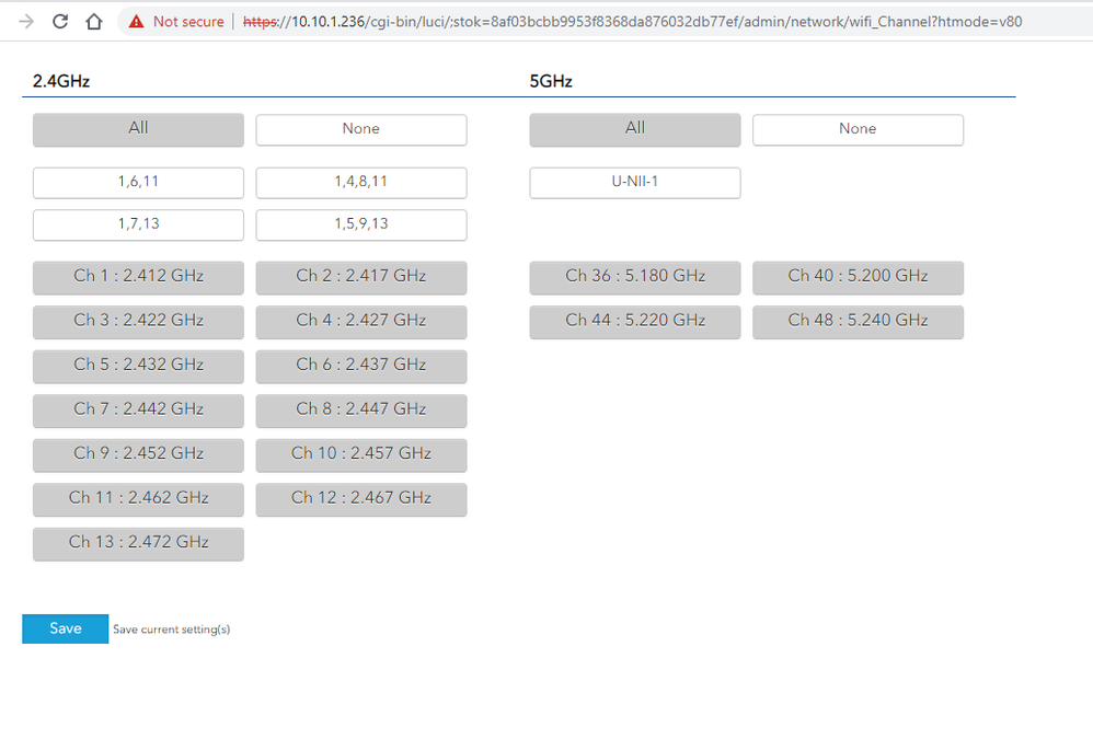

        Does this new WAX214v2 support - different from the current WAX214 and WAX218 releases - a bigger selection of 80 MHz channels? With the limited 5 GHz channel availability, deploying the models suggested (either multiple, or along other AP and routers) is very difficult due to obvious interferences called - lack of options to have dedicated 5 GHz coverage on air.
        Needless to repeat it again: The current limited selection of VT80 channels (read: just one set!) is not acceptable - no alternate channels, no DFS, ...
        TIA
