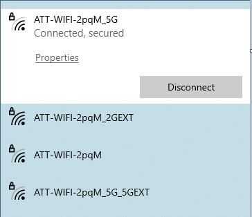

NightHawk M1
I have an NightHawk M1 (SN: 6A8112NV52139). According to the AT&T coverage map, I'm close to a 5G coverage area (red circle). The M1 see what is in picture to. I know an M1 is supposed to be only 4G LTE so why am I even seeing 5G (ATT-WIFI-2pqM_5G?. Also, I can connect to the 5G and my speed almost doubles (30-40 mbps) over 4G (ATT-WIFI-2pqM) (20-25 mbps).

There's 5g cellular (5th generation) and 5g wireless (5ghz).
They're different. what you're seeing/connecting to is the 5ghz wireless.
The M1 isn't 5g cellular.

Got it thanks. I only use the M1 for my wireless so what you say explains it.
