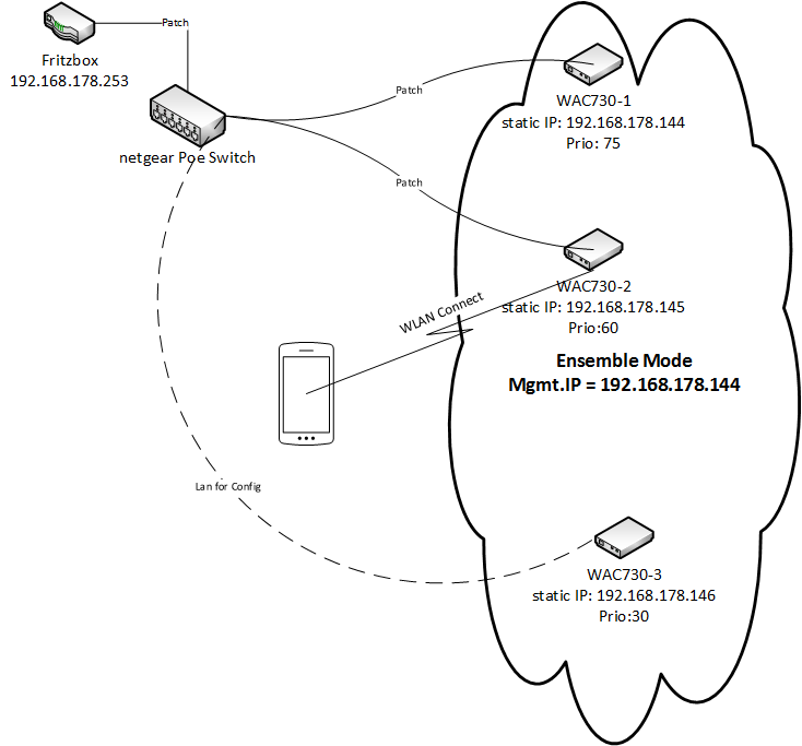

Hello there, I'm thinking of someone having the same Problem as we have. I shortly explain the Situation: We own a Internet Router which is connected to a netgear Poe-Switch. On the Poe Switch 2 LAN Cables connect two of the 730 WAC, which are in Ensemble Mode. The third WAC730 does not have a Lan Cabling but we configured it with LAn-Cabling into the Ensemble mode. Everything fine up to here. When we disconnect the third WAC730 from LAN, only has the WLAN Connection instead, it disappeares from the Ensemble. Priority and Security Ensemble Key are all correct. What is going wrong here ?

This is what was configured in my understanding, as there is no Extender mode on the WAC730. I don't thingk the OP was so blue-eyed that it works without a configured wireless bridge. But then we're at the same point - in my L2 understanding, the wireless bridge would make another segment, like the LAN segment on the detached WAC wold create a third L2 segment.
Do you expect that multiple WAC730 in wired and bridged config would allow to operate as a single Ensemble?

So the point is if a WAC 730 can be member of an Ensemble if connected as a wireless bridge? I fear this is not possible, because of the wireless bridge does form it's own bridged segment - see the WAC720/730 User Manual p.87 ff:
Set Up, Manage, and Monitor Ensembles
An ensemble can be formed between two more APs if the following conditions are met:...
. • The APs are connected on the same bridged segment.

schumaku thank you for your Reply this would mean we cannot "Ensemble" the three AP's with the Router (i.e. Fritzbox 6490 ). So this would only be possible with a netgear WLAN Controller ?Huh, where did I said anything about a controller?
There can be no Ensemble with the router, the Ensemble can just span multiple WAC730 (same model), and just on the very same bridge segment what can be the the switched LAN of the Fritzbox of course, too.
In my networking world (and I can be wrong) the switched LAN and the wireless bridge make up two different segments. That's the point. Let's see if RaghuHR will confirm that it should be possible to operate the Ensemble with the non-hardwired WAC 730.
What hit my eyes - is it possible the WAC 730 firmware is slightly aged? Consider an update.
