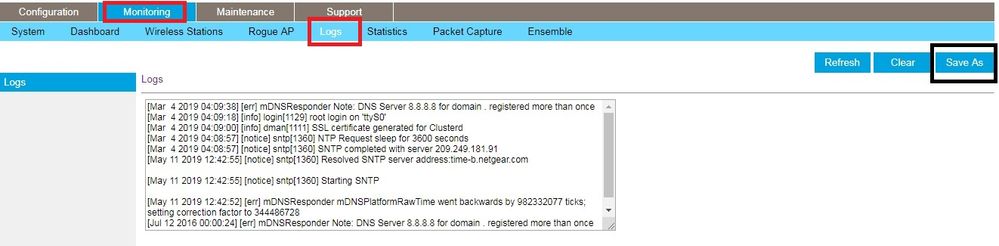

    Welcome to the Netgear Community. Could you please save the detailed logs of the affected APs and send it for us? We will take a look.
    Btw are you seeing this issue with some wireless clients such as iPhones or Android phones and Windows? Please share detatails.
    I have attached screen shot on how to download the detailed logs. You can upload into google drive and share me link via PM.
    Thanks,
    Raghu
