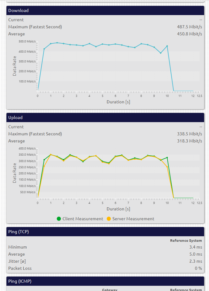

What wireless clients are in use?
Keep in mind the WAX214v2 can reach 550...650 Mb/s with ease.
Under average conditions (non-exclusive usage of the air and the Internet connection), allowing 80 MHz bandwidth on the 5 GHz band. My WAX214v2 ad-hoc set-up playground system showed this half an hour ago:
