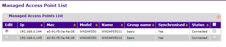

I tried again, following your directions in the document. This time I was able to dicover and connect to my 2 WNDAP350s, but not my 11 WG103s. Here is a line by line response to your supplied document.
1) configued 5316 Controller IPs. Has always been
IP: 192.168.0.130
SN: 255.255.255.0
GW: 192.168.0.1
DNS1: 8.8.8.8
DNS2: 8.8.4.42 i) Business Central OFF
2 ii) SNMP enabled all APs
3 i) I discovered APs using Auto Discovery not IP range. IP range did not work. Auto discovery
only found my 2 WNDAP350s, but none of my WG103s Ive had for years.3 ii) successfully added 2 WNDAP350s
3 iii) SNMP empty
3 iv) added correct password, synchronization started and finally succeded. Both WNDAP350
Connected. However, my11 WG103 are not connected or discovered.- LaxmankumarGAug 22, 2018NETGEAR Expert
