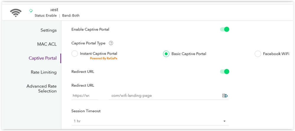

I have a Guest SSID that works as an open network. When I turn on captive portal, that works too. When I turn on and add a Redirect URL, the redirect does not work at all. Any issue with this field? I have a website that worked when we were using Comcast's WiFi pro, and is still works now. Is there a bug with this field? Is there a specific format, like leave out https:// or www? Thanks for any suggestions.

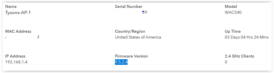

      3. I believe the firmware is up to date (see pic)

        Update to this issue - after testing on multiple devices, the issue seem to be tied to Android devices only.  On a Windows laptop or iPhone, after clicking Accept, the browser is redirected to the landing page.  On the Android devices (specifically speaking, OnePlus OxygenOS), the WiFi connection manager opens up a proxy or embedded browser, which opens up the Netgear Accept page.  The browser doesn't recognize the redirect to my setup webpage.  Unsure how this is going to be resolved.  Will test on more devices.
