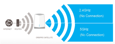

- BruceGuoNETGEAR ExpertHi I don't see the limitation. Can you draw your topology and our SW team will reproduce the issue. See if you can provide debug files so that we can import your configuration. Bruce NETGEAR - Theo_CTutorHere is the topology, RED satellites are seen by the router as wired but no equipment can connect to them, GREEN satellites are also seen by the router and equipement can connect to them. Devices can also connect to the router in AP mode.
 I don't really have any logs to give you, the satellites don't have any, and those from the router in AP mode aren't interesting.
 But here are two screenshots to show you that there's no equipment on it.
