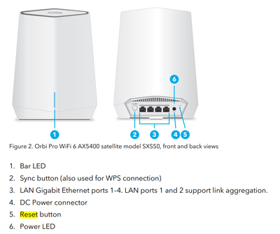

  • Hi hugo55 ,
    Thanks for connecting to Netgear community forum.
    Yes, there is an option to reset Satellite using pin. There is a small hole next to power input.
    Router or Satellite to its factory settings. Use the end of a paper clip or a similar object to press and hold the Reset button on the back of the router or satellite for at least seven seconds. The router or satellite resets and returns to the factory settings.
    Blinking amber: The router or satellite is resetting to factory default settings.
    Please refer screenshot.
    If you still have a issue, please pm me or will connect over zoom call.
    Thanks,
    Basavaraj

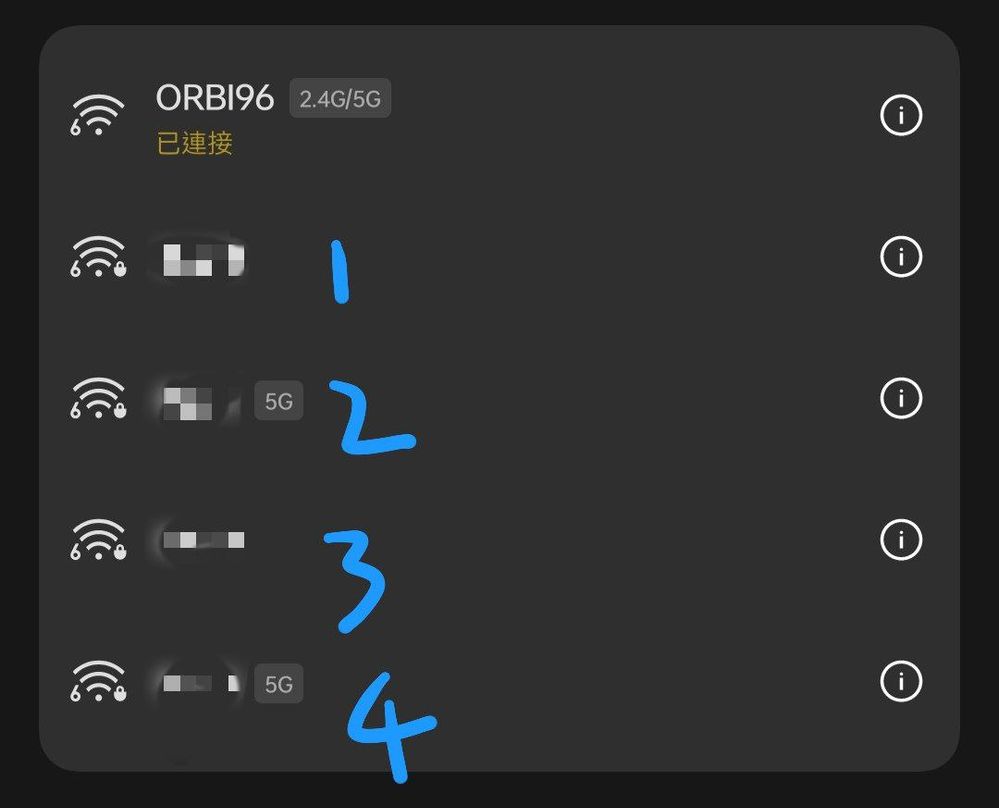

    • hugo55's avatar
      hugo55
      Tutor
      Hi, just check the firmware has been update automatic, the GUI language can be upgrade.
      But the wifi network [ORBI96] still sharing without password.
      I tried to connect with my phone and check the console shows that it is connecting to the network [4] belong to Orbi Pro SXK50 Satellite-1.
      I have check all the wireless are using different password. Both wireless 1-4 are need password to connect.
