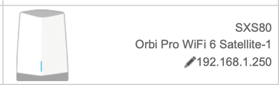

Satellite goes to solid magenta again, however it show up in the router settings with IP address 192.168.1.250 which I can ping.
If I access the page by browser it shows me all the connection devices (wired and wireless) from the router itself, which makes no sense since nothing is connected. After removing the utp and restarting the satellite, solid amber, solid blue, solid amber and again to solid magenta in a 2 minute period. Then it goes back to blue again for a few minutes, then back to blinking white, back to amber, back to blue and back again to solid magenta.

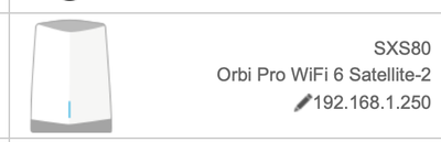

      What I can see now (after reboot 100) is while being magenta, i can reach the satellites but they both have the same ip address... gets stranger and stranger.

      There was no manual update, so I don't know when which SXS or the SXR was updated. SXS's were added one at a time. I am now trying to force them both into an ip address. They were added from the web page. Running firmware V4.3.3.200 I have now changed the IP address of one of the 2 satellites to 192.168.1.201 and left the other one offline. It seems to be running ok for 2 hours now. Have connected the second one again just now, which now gets IP address 192.168.1.43. Both have backhaul to the SXR80. Will see if it stays stable in the coming hours. Don't know what has happened ...
