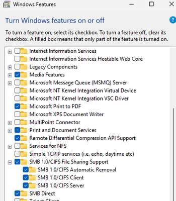

#Go to Programs and features
Under Turn on Windows Features
->SMB-1.0 File sharing support <<<<<<<<< There are 3 options nested. I always checked all 3
Restart then turn SMB off <<<<<<<<<< over time, these instructions stopped working unless I left SMB ON.

SMB 1 (and options) is active. The only evident difference between you and me is the model of the router. Thank you for responding. W11 is configured just like the working W10 except for I can map drives on W10 machines and can't seem to on W11. - WacoJohnLuminary

smb1 is ON.
