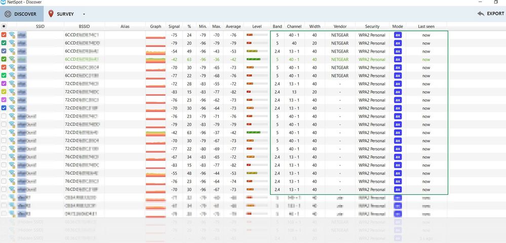

  4. Then I started setting up WiFi and figured out that WIFI settings were not distributed properly to satellites: NetSpot showed that router and satellites aired wifi in different modes:

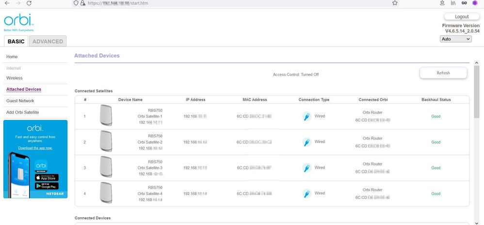

  5. Despite the fact that all satellites a showed as synced (all of the have reserved IP addresses on the DHCP server):

    • Issue #2: Once all Satellites got synced I noticed that they work in different WiFi modes (which were set during sync in Router mode). Changed WIFI settings (e.g. channel) was not propagated to the Satellites and only applied to the Router.
      Here I spent also around 2 hours trying different approaches like switch off everything, switch on Router and ensure its WIFI in right mode, then switching on Satellites one by one and observing that they do not pick up right WIFI settings from Router and instead use settings from the time when they were synced in Router mode.
    SW_, in case you would have time - you may try to change WIFI channel on your Router and then verify whether updated channel was applied to all Satellites as well.
    FYI: In my case Satellites connected to the Router by wires via LinkSys LGS116 switch. Once again: simply by changing from AP mode to Router mode and without any changes in the network topology - everything starts working fine. When in AP mode - WIFI settings are not applied to Satellites. So for me it is a confirmation that issue related not to the switch or wires or whatever else on my side, but instead related to the AP mode, or am I missing something?

        One thing you could try to verify if the changes are propagated correctly to all Sats is to rename the SSID to something new so that none of your WiFi clients can connect to it. WiFi clients can affect Sat's WiFi "Bands" seen via NetSpot if that client has trouble with 80MHz or 40MHz and decides to switch to 20MHz for better connection.

  • SW_, thank you for testing wifi changes propagation and great that it worked well. As per ssid name change - yeah, I did that as well, but had no luck in AP Mode.
