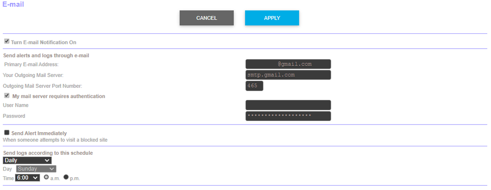

For ANY users seeing mysterious reboots of there 7 or 8 series RBR routers rebooting at random or at specific time frames, we'd like to ask you to enable Email Logging of the RBR and configure it to send email logs to a email account of your choosing:
After the Orbi is configured, observe and monitor the received logs and monitor the RBR's IPaddress/debug.htm web page for System Uptime. Take notice of the current time and observe this web page for next 24-72 hours. Observe and monitor any wireless or wired disconnections or any application pause or application disconnections during this time frame.
Gmail Email Configuration:
I use Gmail on mine and on May 31st Google disabled and removed Allow Less Secure apps on there services so if you use Gmail, you need to enable 2FA on your Gmail account profile then as for a 3rd party application Password thats generated by Google. Input this in to the RBRs email configuration. Password given will be a random 16 character (???? ???? ???? ????) format.

Ok, enabling email logs seems to help stop the RBR mysterious rebooting. Mines been online for 4+ days:

So part of my initial installation of the RBR850 on an RBK853 system was to setup the eMail Notification. For a short time it wouldn't work. Once I reviewed the settings, I realized that the Outgoing Port was set wrong for the type eMail I was wanting to use. Once I changed that from the default, every thing has worked great since. And has since except when I put all my IoT on my Guest Network. I started getting my set eMail at Midnight and now 3 others throughout the day depicting the Guest Network Shuffle. I wish I could turn that off. Although the eMails range from the whole Guest Network IP range of devices shuffling to one or two entries when a device(s) dropped off or lose their way. I wish I could do IP Reservations for GN Devices.

- I enabled email logging by adding incorrect email configs and credentials. It seems to bring stability still, so just enabling it without working is enough.

I upgraded my whole setup to Firmware Version 4.6.8.5, did a factory reset on the RBR850, applied all my previous parameters from a backup, and enabled the Email Logging quick fix as described.
It did work for 1 day and then connection dropping problem came back.
My second attempt has been working since 4 days and here is what I did.
Factory reset the RBR850, re-created my parameters configuration from scratch and not from a backup, applied the Email Logging quick fix with a emailing frequency every hour instead of every day.
I am guessing the process of emailing logs is clearing out file space thus preventing the RBR850 to go in the buggy mode.
And because I have 70+ connected device, I have to run this process on an hourly basis instead of daily basis.
