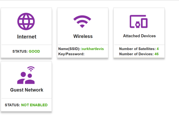

When I log onto my routers through a browser interface, the connected Satellites do NOT show up.
As can be seen below, I have 4 satellites connected.

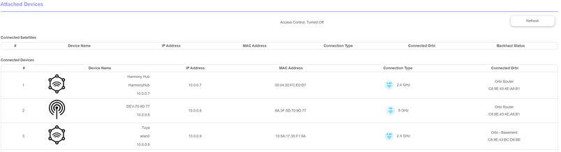

But, when I click to see attached devices, they do NOT show as can be seen below.  They used to show up and show me the connection quality.

      The satellites are definitely connected and we can see devices connected to them.
      If I unplug a satellite, it shows up as a disconnected satellite.  When I plug it in, it no longer shows as a satellite, but it is definitely connected.
