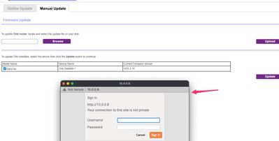

RBS750 Unable to fetch new FW version. The below status staus forever.
Tried manual upgrade of RBS750. Not sure how/ which credentials to login to the popup login page
Could someone help, please!
I am not sure why my screenshots are not updated in my above post .. so here is what is happening
- Found Router & Satellite firmware new version
- Current version
- RBR750 V4.6.3.16
- RBS750 V4.6.3.16
- New version found
- RBR750 V4.6.5.14 https://www.netgear.com/support/product/rbr750.aspx
- RBS750 V4.6.5.17 https://www.netgear.com/support/product/RBS750.aspx
- Unable to get online update active as the satellite got stuck at "Please wait a moment" as status forever
- Tried Satellite FW update manually but i get a login screen saying "Your connection to this site is not private"
I am not sure what credentials I need to use and why is this screen popping up.
- Surprisingly after several tries I started seeing the updated firmware for both router and satellite. Clicked update allFinally the update completed successfully and I could see in the Online Update >> Status table that both RBR750 and RBS750 are updated to V4.6.5.14.
But the version info on the top right corner still shows older version V4.6.3.16_2.0.51After a couple of refreshes the version info on the top right corner also got updated to V4.6.5.14_2.0.54My issue is resolved. Thank you!
- Firmware still broken.
Satellite still regularly cycle between white flashing light, blue, nothing.
