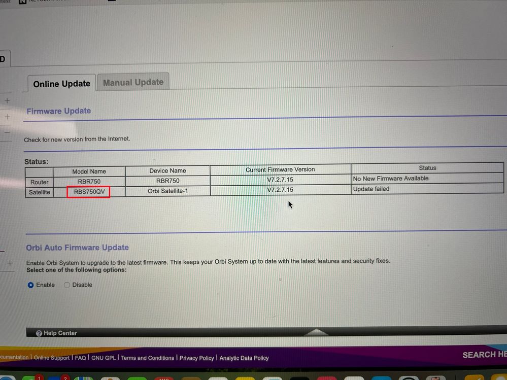

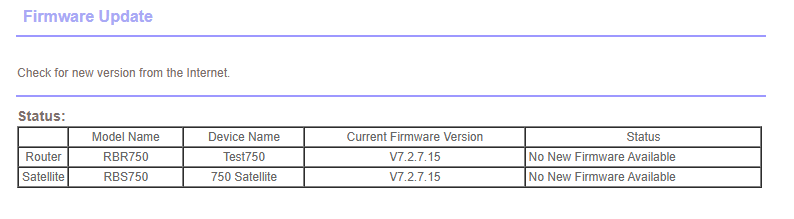

Just curious, if anyone with a 750 series system has noticed that there RBS750 reports a QV after the system is updated then check again for a FW update, on this page, does the RBS750 model string appear correctly for your RBS?
Not for me:
Good. Thank you.

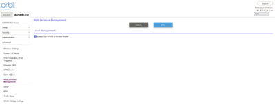

I have 2-pack RBR750 and RBS750 that I've just manually updated to V7.2.7.15_5.1.16 (the automatic update wasn't showing the new version).
Something must have broken with the HTTPS certificate, because now every browser issues the security warning when trying to connect to orbilogin.net or 192.168.0.1. I tried to manually install the certificates following this (https://kb.netgear.com/000061003/I-get-a-security-warning-in-my-browser-when-I-try-to-log-in-to-my-NETGEAR-or-Orbi-router-what-do-I-do) but they appear invalid.
It may be related to the setting below that somehow I cannot uncheck (Advanced -> Advanced -> Web Services Management -> Always Use HTTPS to Access Router)
Anyone experiencing this? There's a bunch of topics from the past on similar issues happening in many Netgear routers, but very much unclear on how to fix. I'm not 100% sold on just ignoring the warning.
