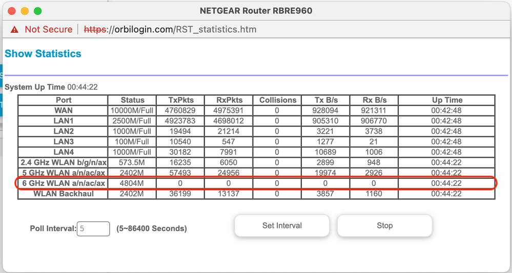

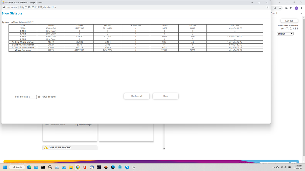

FURRYe38 what is the best process to provide feedback to Netgear on issues with firmware? Seems there was a small regression on this newest version. Statistics for the 6Ghz are back to showing as 0 across the board. I had seen this before in a previous version, but it had been working in v6.3.7.5.
What browser are you using?
What process did you use to update the FW on the system?
Did you power cycle the system OFF and back ON after new FW as loaded?
Has a factory reset and setup from scratch been performed yet?
Do you have the 6Ghz separate SSID enabled?
Do you have 6ghz devices connected currently?
There is a reason why these FW post are here...

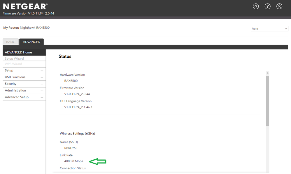

So here is a first to date ever seeing 4800Mpbs connection rate between two devices. 😲
RAXE500 in wireless bridge mode connected to the RBKE960 on 6Ghz:

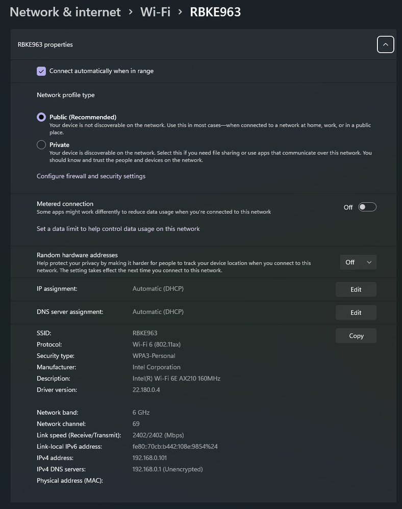

Intel AX210 6Ghz wireless PC connected:
