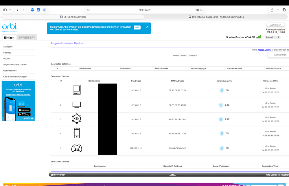

  • Thank you for your support. I've followed your steps exactly; unfortunately, no change. I reset both devices and configured the network again. However, the satellite does not appear in the list of connected devices and cannot be found during the setup, nor by trying to add the satellite later through the app or web interface of the router. See here:

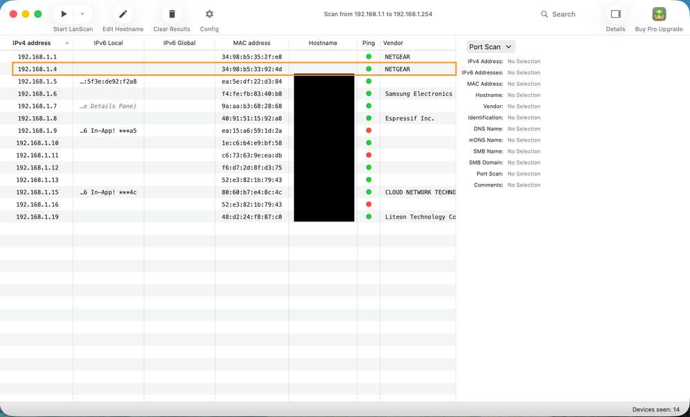

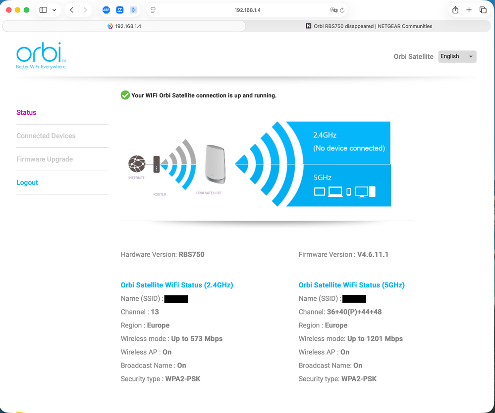

    Regardless, through an IP scan, I can see that the satellite connects, and I can access its user interface through its IP address. See here:
    What to do?
