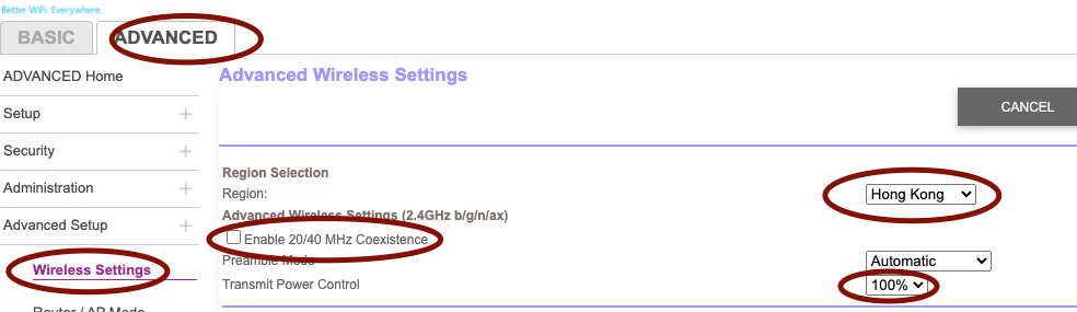

  • Hello!
    Didn't set the 2.4G transmission below 100%?
    I also had this problem, but with this setting ok:

  • CrimpOn's avatar
    CrimpOn
    Thanks for posting the screen shot.  That is INSANE.  I have no idea how this could happen.

  • Hello!

      mllrgy wrote:
      Hello!
      I am trying to uncheck 20/40 MHz coexistence now. I can't revise my region, it's NA now.
      • N4cE's avatar
        N4cE
        Guide
        Update:
        Today is my 3rd day after unchecking the 20/40 Mhz coexistance(I only change this one).
        My 2.4g is still online! I will keep monitor if it's working normally and feedback to this thread.
