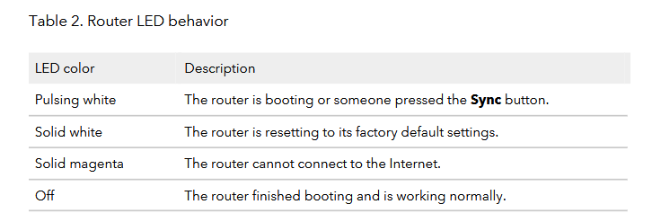

Problem: Router powers on, white light flashes for about 1 minute then all lights go off completely. Unit is in a permanent boot loop and cannot complete startup.

  • This issue was resolved with factory reset which for some reason wasn't going through in my initial few attempts. Also with firmware update my routers pass through speed has increased 7-8x than earlier. Thank you.
