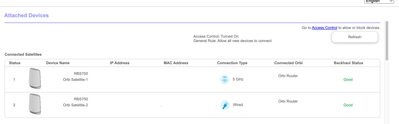

Hi!!
I have rbk753. I want to connect the farthest satellite by ethernet backhaul behind a switch...I have outages and want to improve my connection. When I connect the satellite directly to the router is fine. I can see "Wired" as "Connection Type". (With the same wires as when it does not work)
But when the satellite is behind the switch (GS108Tv3) I only see "2.4 GHz" or "5 GHz" as "Connection Type".
I tried on the switch:
- Disable EEE Mode
- Disable IGMP Snooping
- Flow control Symmetric on satellite's port
Nothing works
Any attempt is welcome. I have seen in the forum: connection on WLAN port, cable problems, and other switches...
Thx
  • Fixed!!
    Add the solution:
    The main issue was having a computer connected on wired and wireless at the same time.
    This causes a loop inside my network.
    My Switch when detecting a loop disables the port for admin mode so that backhaul is not functional, though the normal traffic was ok...
    Simply turn off the wifi on my computer then backhaul started to run correctly.
    Thanks all for your support

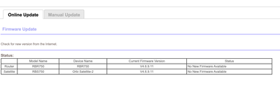

    What Firmware version is currently loaded? Make sure the RBS has same version of FW as the RBR.

      Yep, the same version V4.6.9.11
    Is it correct to read the same wires as meaning that the satellite was working
    • At the remote location,
    • With the same Ethernet cable to a wall jack
    • With the same Ethernet cable wiring from remote location to patch panel
    • With the same Ethernet cable from the patch panel to the router
    • And the only change is that the patch cable was moved from the router LAN port to a port on the GS108T switch?
