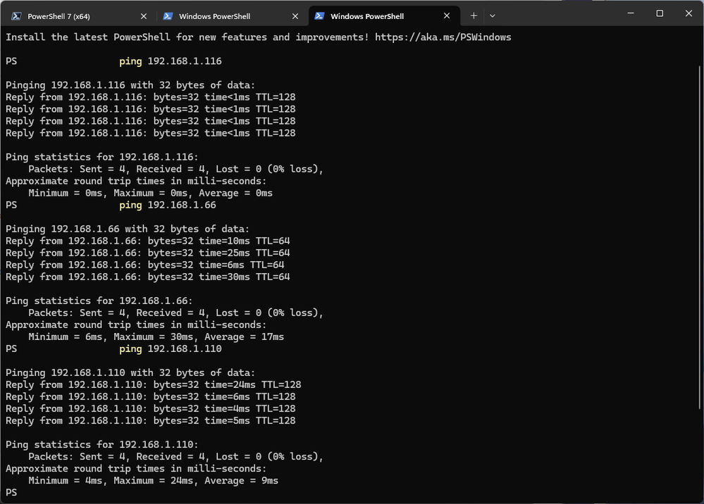

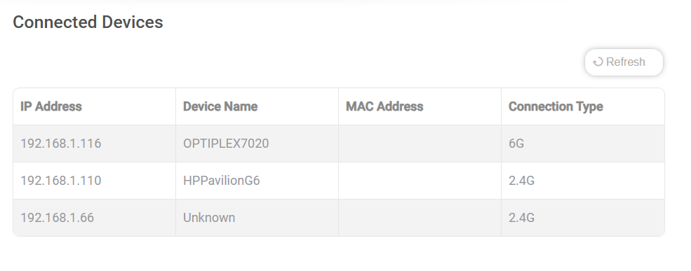

      Ok checked my 770 series system. One RBS connected wirelessly to the RBR. Connected up a old ASUS RT-AC66U router in wireless bridge mode connected at 2.4Ghz. Placed the ASUS bridge near the RBS to ensure it connected there. Have on HP laptop connected ethernet to the back of the ASUS bridge. Getting a 192.168.1.110 IP address for the HP laptop. ASUS bridge is set to static IP address of 192.168.1.66. Both connected at the RBS. Have a Dell Desktop PC connected to the same RBS with a AX210 series wifi adapter connecting at 6Ghz here. Getting an IP address of 192.168.1.116 for the DELL PC. All connected to the main WLAN.
      Ping is successful from the Dell PC to both the Asus bridge and HP laptop:
      Ping from HP laptop connected behind the ASUS bridge is successful as well pinging the DELL PC on 6Ghz.

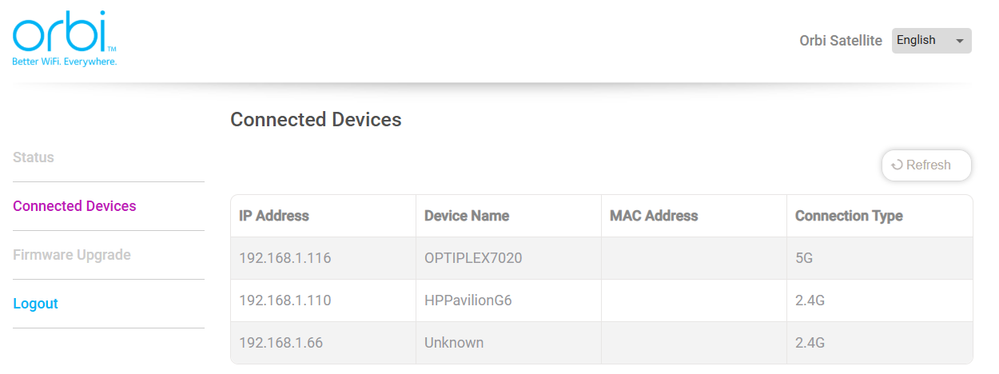

        Ok so did a quick test on my 370 series. Same configuration with devices used on the 770 series.
        Ping is successful between 2.4Ghz and 5ghz in both directions from two PCs, laptop connected ethernet to a ASUS bridge connected to 2.4Ghz at the RBS.
        Desktop PC connected 5Ghz at the RBS.
