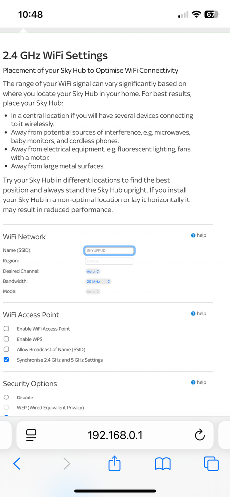

As sky doesn’t allow bridge mode I put my Orbi in AP mode and turned off the WiFi on sky hub.

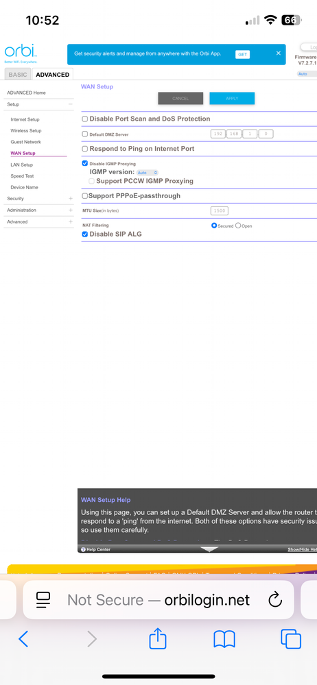

    Try disabling the following and see:
    Armor, Smart Parental Controls or Circle, IPv6, Traffic Meter.

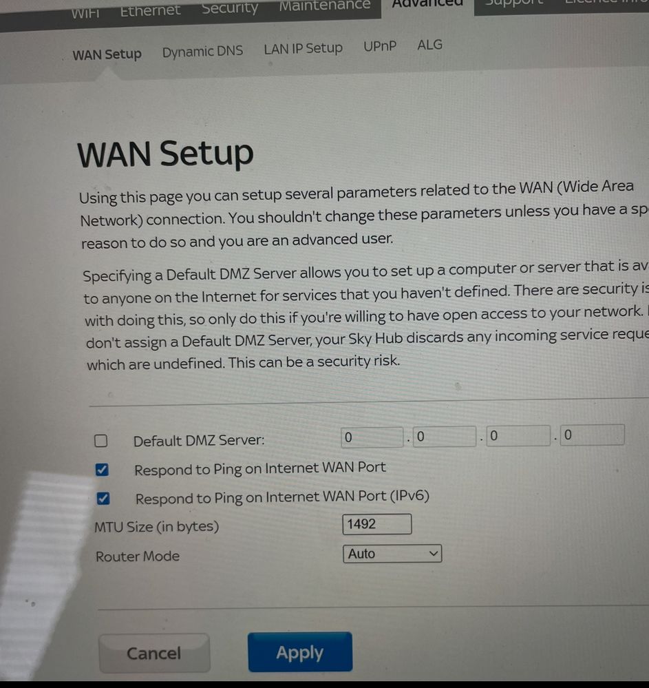

    Does the SkyHub have a DMZ? If so, try the Orbi system in router mode in the Hubs DMZ.

    • FURRYe38's avatar

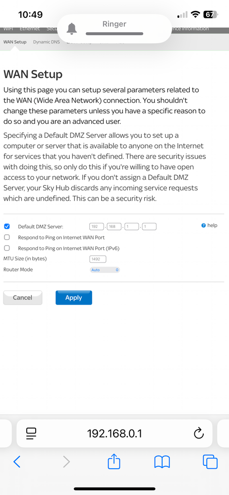

      You could enable DMZ server for the RBR in Router mode if you want to try that. I would. See the IP address on the RBRs web page under Advanced Tab/Internet Section for the IP address. Input this IP address into the modems DMZ Server there and check mark it as enable then select Apply.
      I would remove the check marks for Respong to Ping on Internet WAN port and WAN port IPv6. This means nefarious scans could see your modem. A security risk if enabled.

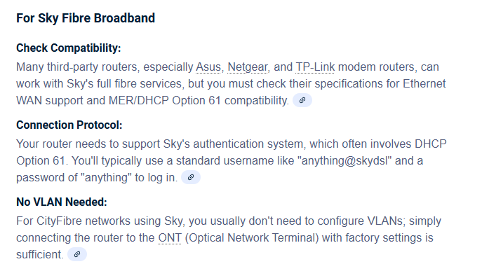

    Sky offers several types of internet.  Which specific Sky service is this?
    For example, customer routers can connect directly to Sky fiber:

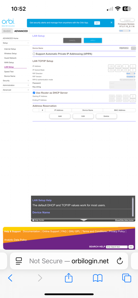

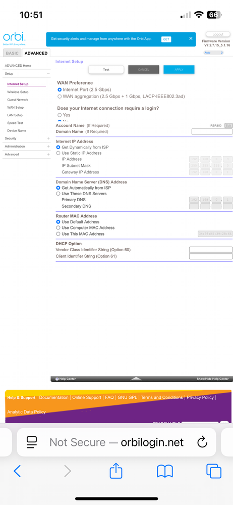

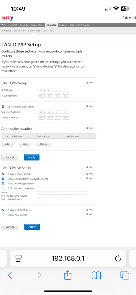

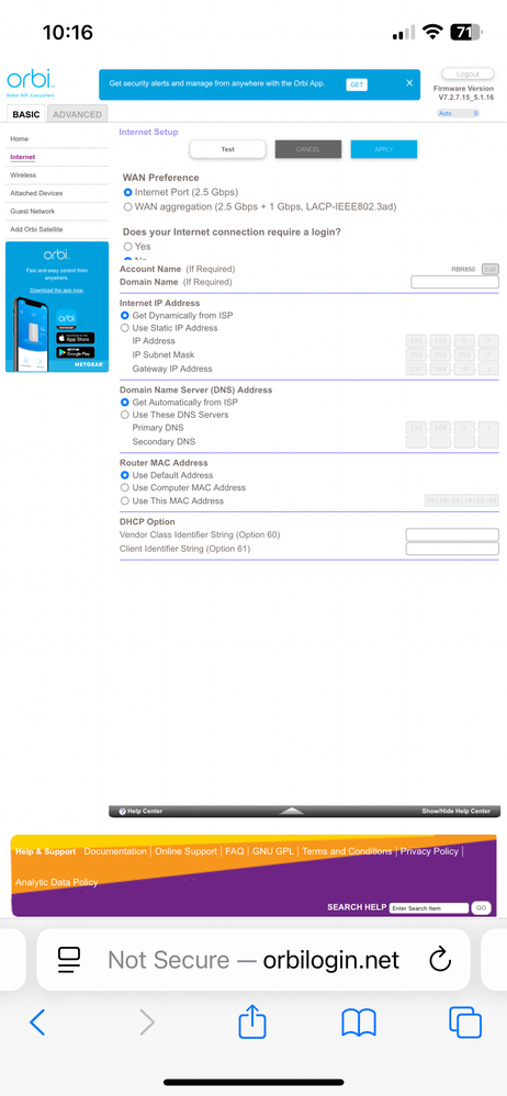

  • Hi guys
    i tried the DMZ option and put Orbi in router mode.
    i see I have that option 61 on Orbi that sky needs
    ill attach he’d a few pics of setup of sky router and Orbi router.
    i may have made mistakes but it working.
    if ye would check to see did I do anything wrong that would be greatly appreciated
    thanks
    • FURRYe38's avatar
      Ask the ISP if the Option61 is needed if the Orbi router is behind the ISP Router. I don't believe it maybe needed since the ISP router maybe handling this already, however never hurts to configure it as see. The ISP will have this info. If it's working good, then you might leave it for a while and run some tests and let the family check it out and give you feedback.

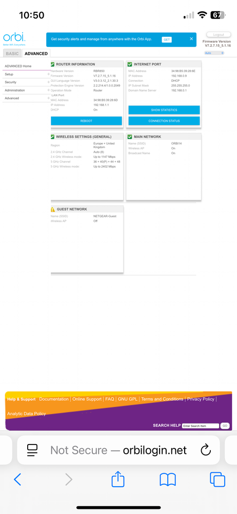

  • StephenB's avatar
    StephenB
     Now I get full signal but internet very slow to load any webpage,YouTube etc
    it works but so slow.
    FWIW, I am not seeing the ORBI screen showing AP mode in your screenshots.  That is on the advanced tab (then select advanced setup in the left pane).  It'd be good to confirm that you are in AP mode.

    • FURRYe38's avatar
      I believe he's in router mode since I mentioned using the DMZ on the host ISP router and to try router mode on the Orbi, and he seems to have configured the DMZ for the RBR. So AP mode would not be needed for this configuration.

  • CrimpOn's avatar
    CrimpOn
    In all of this, I cannot seem to find confirmation of which specific Sky service this is.  If it is fiber:
    • There is no need for the Sky Hub at all.
    • The RBR850 can connect directly to the fiber ONT in the default 'router' mode.
    • There will be no double NAT.

  • Hi guys
    I’ve tried option 61 using the string @skydsl and by plugging cat5e cable from ont into the orbi router internet port.
    im not getting any internet
    ill attach a couple of pics if ye dont mind
    thanks
    • FURRYe38's avatar
      I'd go back to what had been working for now.
      Talk to the ISP to see if the RBR and replace there host router and what it takes to make that happen.
