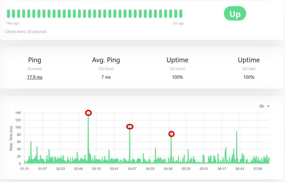

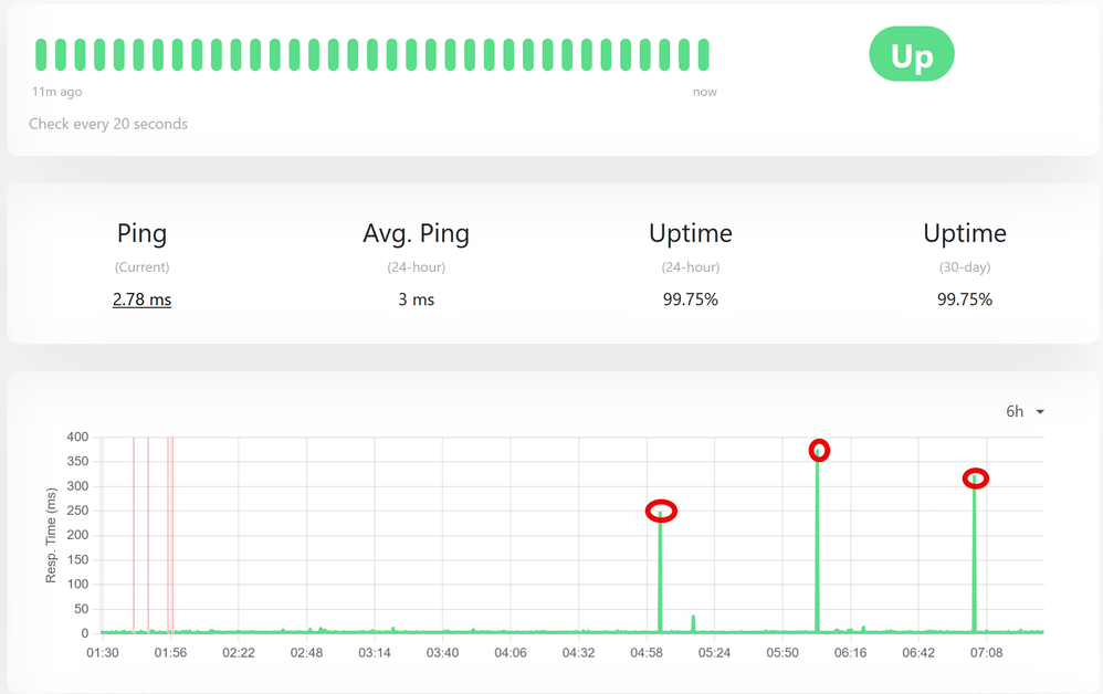

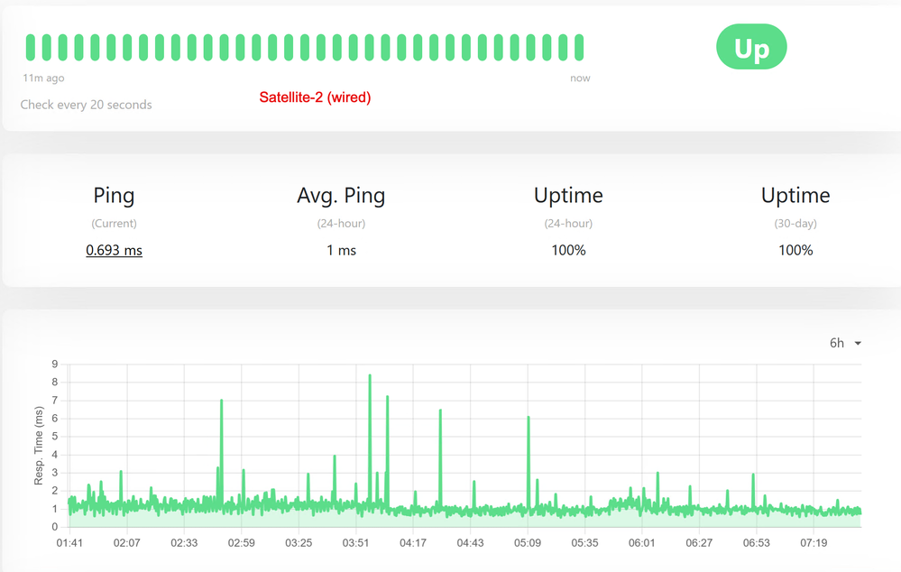

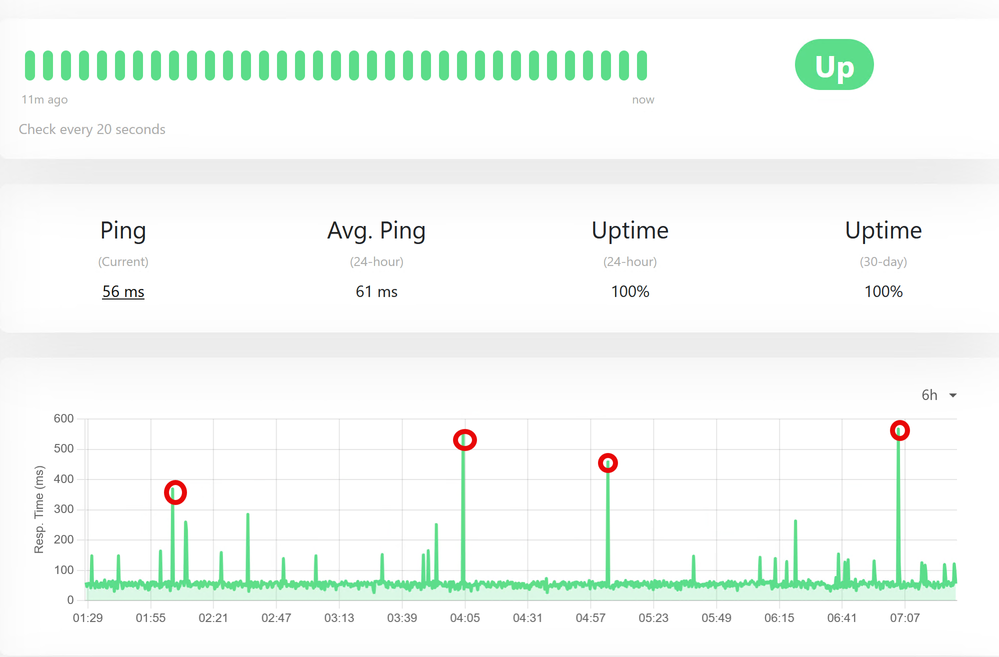

I also installed uptime-kuma on my computer and pinged various devices over the last few hours. I can only set the pings to every 20 seconds, so it doesn't catch all the hourly interruptions. However, you can see the pattern.
In the first three screenshots, I marked the interruptions at xx:03 / xx:04 in red.

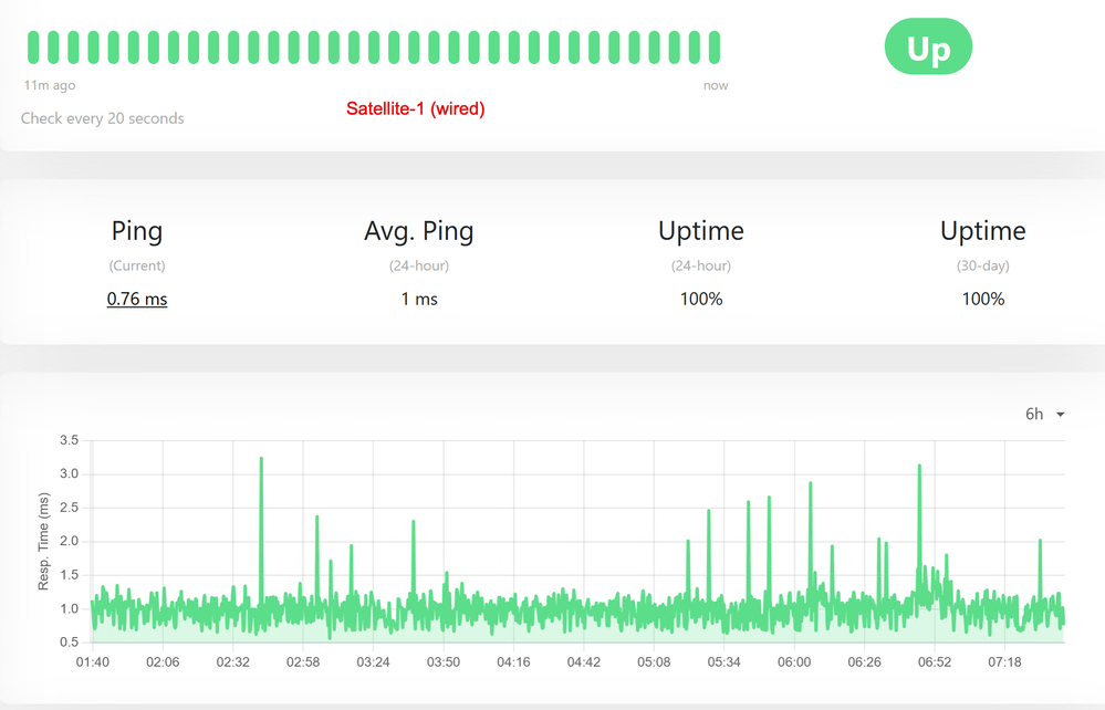

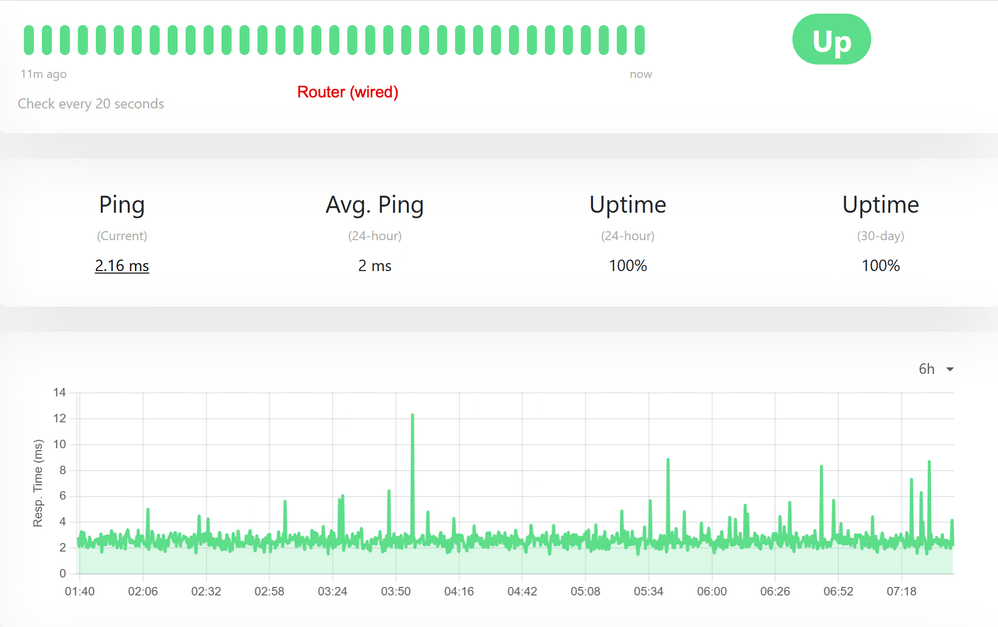

In the last three screenshots, I ping the router and satellites (all wired). I find it interesting that the satellites respond faster than the router. But perhaps that is normal behaviour.

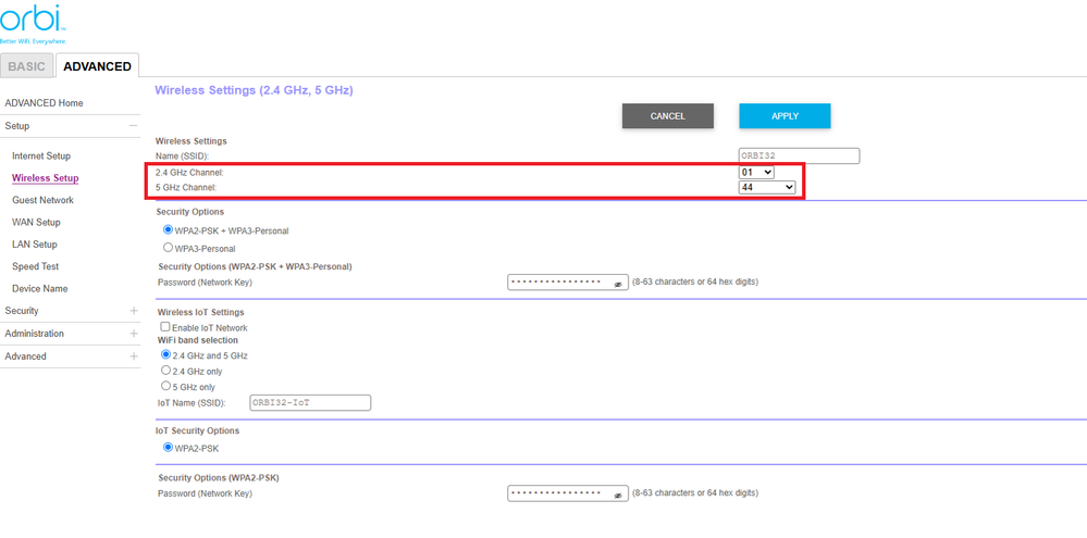

      What channel configurations are currently set on the router?
      - Different configs (48, Auto but also 40, 5)

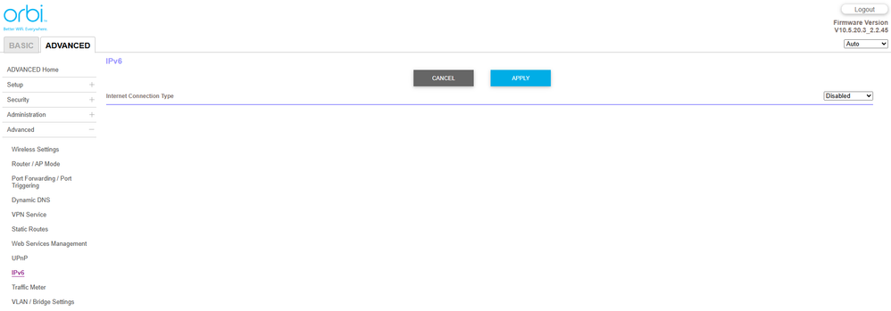

      - All disabled except IPv6
      - Can I disable this over Advanced - IPv6 - Internet Connection Type - Disabled?

        Try channels 1 and 40 or 11 and 48.
        Yes to disable IPv6.
