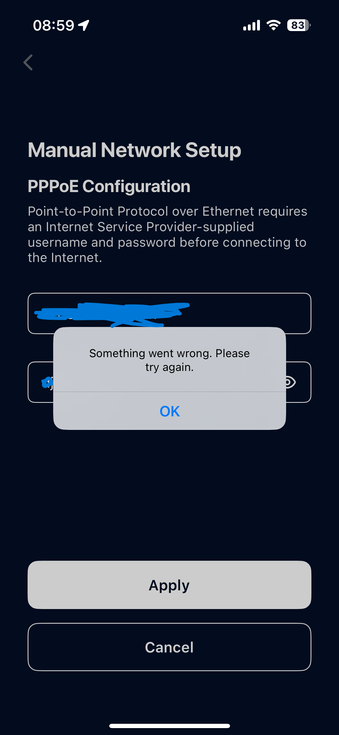

Just recently purchased the Orbi 770 and have been attempting to get the router set up and configured using PPPoE on my full fibre FTTP ISP provided broadband with no luckk.
I'm following the instructions in the Netgear Orbi App and going through the steps but when I get to the configuration stage of entering username and passsword, the app showing the spinnning wheel of death "Apply configuration" and after about 2 minutes I get an error message "Something went wrong. Please try again." See below.

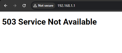

I am also unable to connect to the router via the web to try and configure this without using the mobile app. Going to orbilogin.com or 192.168.1.1 does not take me to the router login page - just an empty browser window loading endlessly and eventually times out to a 502 Service Not Available error.
The internet service works fine when using the Router issued by my ISP here in the UK (Zen Internet) and they've verified this. I've been on the phone to them with the Orbi connected and they confirmed they cannot see any authentication request being made at all.

Managed to resolve with Netgear Support. Hard reset of the router helped me get access to 192.168.1.1 and then followed the web UI to set up the router and then the satellites. Took about 45 mins on the phone but managed to get it resolved.
