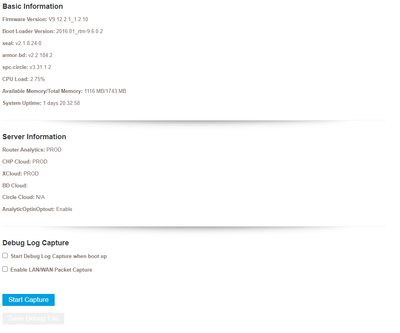

    Can you post the top portion of the text data from the RBRs web page here? 192.168.1.1\debug.htm

        Thanks for posting the debug page information. That looks good here.
