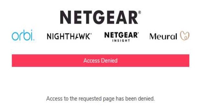

  • I updated the firmware and can no longer login into the router from any of my computers.  I can however access it via the Nighthawk app.
    The login appear to be stuck in an infinite loop, which is showing a serial number different from my router.
    • FURRYe38's avatar
      Probably best to factory reset the router and setup from scratch with a wired PC and web browser then.

    • JoseTv's avatar
      JoseTv
      I updated the firmware today (10Feb24) and I can no longer log into the router from any of my computers. However, I can access it through the Nighthawk app. I am getting the same error. It was fine in the previous version.
      I don't want to go back to factory mode, there is an alternative to revert the version but I can't enter.
      Thanks.
      • 1modulator's avatar
        1modulator
        Guide
        I found if  you disconnect the modem  you can login with no internet connection. Then simply go to the support download page and manually update back to 1.1.3.18. I have no idea why this is happening and have tried everything under the sun factory restarting router and modem in different orders to no avail. I cannot login via PC nor app. There is a new feature being added under Advanced, Security called Protection Engine and have tried disabling it but still no workie. I'm running the updated firmware now and just disconnect if management is needed which isn't very often but pisses everyone in the house off ; ) Hope someone realizes what is wrong and they release a hotfix soon. Good Luck

  • FURRYe38's avatar
    Known Issues:
    For users seeing a Access Denied message after the FW is loaded and processed by the router, users will need to press the reset button in back for 10 seconds then release. https://kb.netgear.com/9665/How-do-I-perform-a-factory-reset-on-my-NETGEAR-router
    Walk thru the setup wizard with a wired PC and web browser at 192.168.1.1 resolves this issue.
    https://kb.netgear.com/22697/How-do-I-install-my-NETGEAR-router-using-the-router-web-interface
    Do NOT load a backup configuration file. Access to routers web page returns. Then go back in and make a new backup configuration to file after the router is set up from scratch.
    https://kb.netgear.com/24231/How-do-I-back-up-the-router-configuration-settings-on-my-Nighthawk-router
    I also saw this issue with my RAX50v2 after updating to v.28 FW. A factory reset and walk thru the Setup wizard solved it and I got access to the WEB UI on the router using MS Edge. Users can revert to prior working version of FW as well.
    If this fails for you, then you'll need to contact NG support and have them help you out.

  • I was unable to log in to a family member's RAX50v2 that I manage for them after this firmware update. After reading this and some other threads, I disconnected the Ethernet cable from the modem to the router and was then able to access the web settings. Disabled the Protection Engine in Advanced -> Security (was on by default), hit Apply, powered off the router, cabled it back to the modem, powered it back on and was able to access the web settings again without having to factory reset. May not want to leave it like this with Protection Engine off, but seems like the jury is still out about what that does exactly (a Netgear support page says it protects against "certain security attacks," and I'm reading that it might be related to BitDefender)?
    • FURRYe38's avatar
      https://community.netgear.com/t5/Nighthawk-with-WiFi-6-AX-and/New-RAX41-42-43-50-54-V2-Firmware-Version-1-1-4-28-Released/m-p/2363771/highlight/true#M37956
      Do this with the WAN cable disconnected from the ISP modem first.

      • nmincone's avatar
        nmincone
        Tutor
         I read your reply early today and took it upon myself to drive to the clients to try this.
        Thank you. That worked! We had never thought of disconnecting it from the WAN to prevent Netgear's wonky URL error from reporting back to home base.
        Again Netgear fix this!
  • was at the clients again yesterday to make some changes and realized the issue had returned, not sure when since my last post but unless the router is disconnected from the WAN there is no way to access the web UI... also noticed there have not been any FW updates from NG since my last post.
    • FURRYe38's avatar
      So after doing the factory reset, and going back later on, the problem returned? Can't access the WEB UI? Seeing the Denied Access web page?
