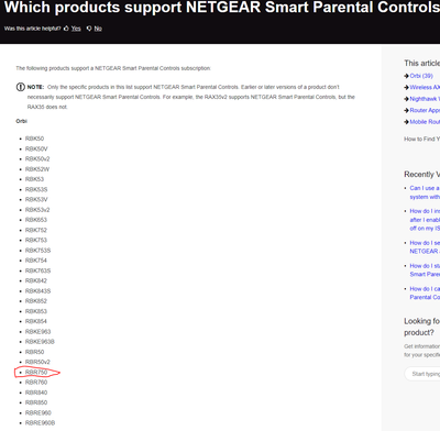

      Thank you, but it does. RBR750 is listed in the Netgear Smart Parental Control list

        The RBR750 Product Data Sheet prominently mentions Smart Parental Control on page 1.
        https://www.netgear.com/images/datasheet/orbi/RBK752.pdf
        and on page 4:
        I find it (almost) amusing that the word "Parental" does not appear in the RBR750 user manual.
