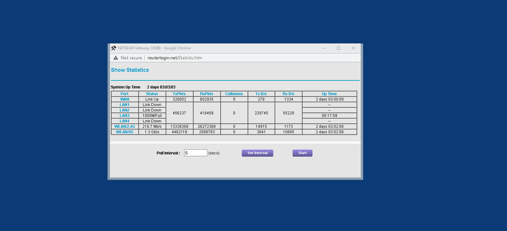

LAN1, LAN2, LAN4 link down on AC1750 Firmware Version V3.01.14
Hi, my ethernet LAN1, LAN2, and LAN4 all have a status of Link Down.  Lan3 is working. My router is the AC1750 WiFi cable modem model C6300.  The firmware version V3.01.14.  Is there a way to fix this or do I have to buy a new router?

    do you have something connected to those ports?
    • SoccerBall12's avatar
      SoccerBall12
      Guide
      I have something plugged into Lan3 which is working. Lan1 is connected to my cable box. Lan2 to my smart TV. And lan4 an Xbox

        Even when I do not have things plugged into LAN1,2,4 they still do not work.
    • plemans's avatar
      plemans
      You can visually inspect the ports and see if they pins are bent/corroded.
      But if a factory reset doesn't fix the issue, about the only other thing to try would be to have the ISP reprovision the modem.
      If the issue is a corrupt firmware problem, that'd be the only way to overwrite it.

        Thanks how would I have the ISP reprovision the modem? I called netgear and they said there is a virus and the only way to have it fixed is to sign up for a $99.99 6 month service.
