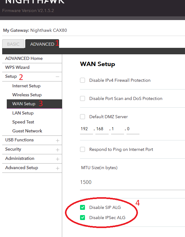

  • Hey, I just got support from Netgear, and I was able to fix it with my current firmware (2.1.5.2)
    May require a reboot. I did out of habit after I changed my settings.

  • There were no SIP alg options for me until I downloaded the 2.1.3.1 firmware.
    • FURRYe38's avatar
      SIP ALG should be seen in the more recent version of release FW. I know mine has it.
      Something to try a Factory Reset and setup from scratch next time you update FW.
