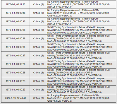

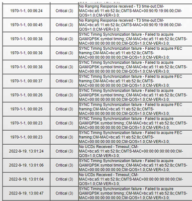

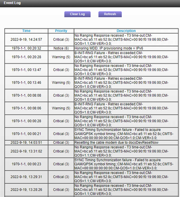

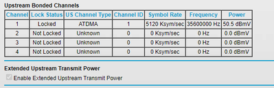

My modem has recently changed to where my Upstream LED indicator is a solid orange color. I've talked to my ISP (Xfinity) and they said everything on their end (power, connection) looks fine and it's likely an issue on NetGear's end. I provided all of the info below I could think of. Any and all help is appreciated.

You have lots of Correctables and Un-Correctables that should be mostly zeros.
Have the ISP check the signal and line quality UP to the modem. Be sure the ISP provisions the modem correctly.
Be sure there are no coax cable line splitters in the between the modem and ISP service box. Be sure all fittings are snug and screwed on well.
Be sure your using good quality RG6 coax cable up to the modem.
Be sure to power OFF the modem for 1 minute then back ON.
https://community.netgear.com/t5/Cable-Modems-Routers/General-info-and-Troubleshooting-for-Cable-Modems/m-p/1530376#M12853
https://www.duckware.com/tech/solving-intermittent-cable-modem-issues.htmlPlease post the Event Logs page output as well.
