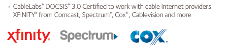

The Netgear support web site does not show any "Downloads" for the CM500. Nor does the User Manual mention anything about firmware updates. The Product Data Sheet claims the CM500 is compatible with the major cable providers:
Like you, my assumption has been that once the modem is connected to the cable provider, they are entirely "in charge" of it. (setting parameters, maintaining firmware, etc.)
