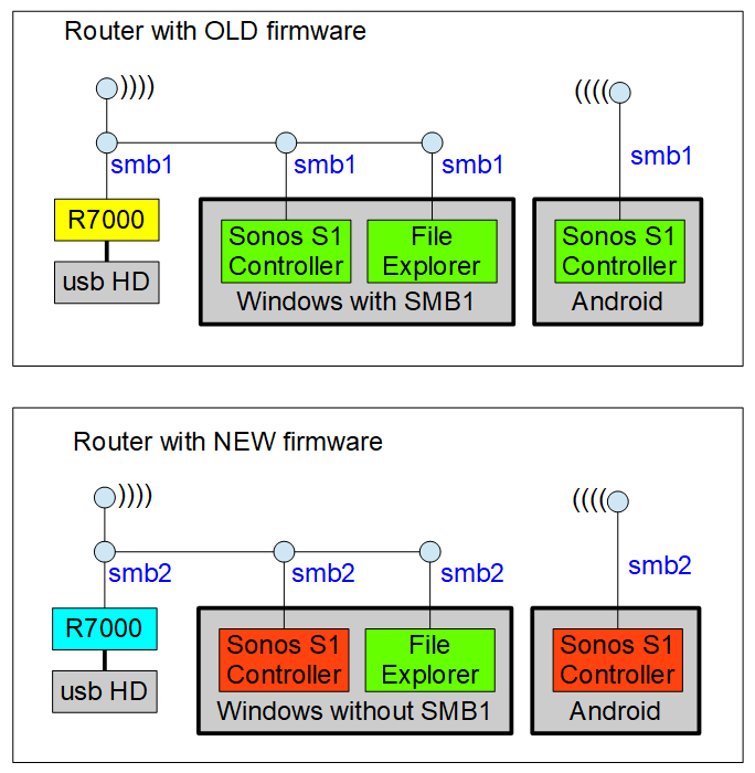

      Allow me a picture to better explain my issue. With the old router firmware file share was using SMB v1 protocol and everything was OK ( Windows had SMB v1 enabled ).
      With the new router firmware file share is now using SMB v2 protocol and Windows (even with SMB v1 disabled) can file share with the router, BUT ... the SONOS S1 application in Android and Windows is permanently dependent on SMB v1 protocol to file share. I do not know the last router firmware that supported SMB v1 or the first firmware that disabled SMB v1. There are so many old firmwares and instead of install one by one to discover I have an expectation someone here knows which one ended with the SMB v1 protocol.

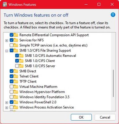

      Almost correct. Microsoft introduced a SMB 1.0/CIFS Automatic Removal service which kicked in if there are no SMB 1.0/CIFS client connections active for a certain time. Check the Windows Features - Turn Windows features on off controls ... it's all there. Yes, it came in with some Windows Upgrade feature enhancements a loooong time ago.

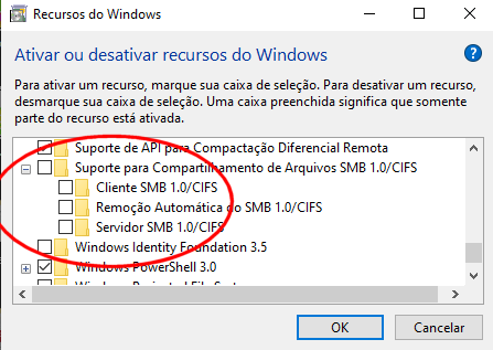

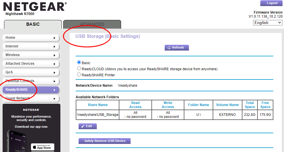

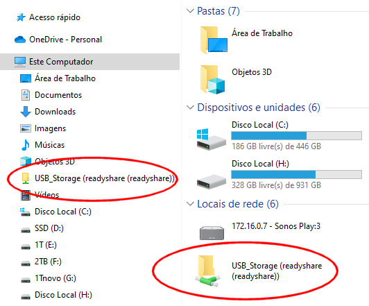

        Allow me to show what I have:
        (1) The ReadySHARE USB Storage page.
        (2) The Windows resources with SMB v1 disabled
        (3) The working ReadySHARE USB Storage local network.

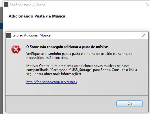

        (4) SONOS S1 network share page
        (5) SONOS S1 error
        R7000 must be working currently with SMB v2 or v3 ( I do not know ). But not v1, for sure.
        R7000 was working with v1 in the past ( do not recall when ) and all was OK.
        SONOS S1 application depends of v1 and it worked for many years.
        Currently it is not working anymore, because R7000 is working with SMB v2 or v3.
        I need to move the firmware back to a version that was using v1 but I do now know what.
        Does this make sense?
  • schumaku's avatar
    schumaku
