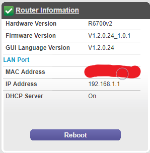

 I'm running Windows 10 Home 64-bit, Arris SB6183 Suddenlink modem, Netgear R6700v2 firmware V1.2.0.24_1.0.1 (latest from website). See Router Info picture.

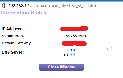

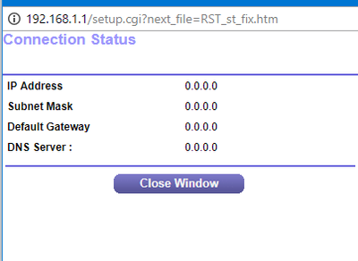

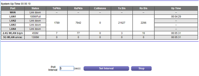

No internet connection. More specifically, the internet statics show the WAN link is going on and off rapidly. It will sometimes say link down and others it says 1000mb/s (see Internet Statistics: WAN Dead and Internet Statistics: WAN Working photos). When the link is working, I get an IP address and gatway (see Connection Status: WAN Dead/Working photos). The WAN only tries to come on when I attempt to access the internet, all other times it's down. Suddenlink tech confirmed 400mb/s is coming out of my cable connection.

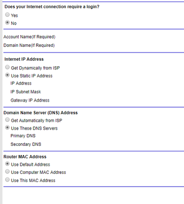

  • Played with internet setup using all options (dynamic and static dns/ip/gateway)
    • I recorded my dns/ip/gateway from when the modem is plugged directly into the computer and input that into the router
  • Plugged modem directly into PC (the internet works when doing this, but limited to 100mb/s)
  • MAC spoofing: I've tried the MAC of my PC, the "Default" in settings, and hard-coding the MAC from my modem
